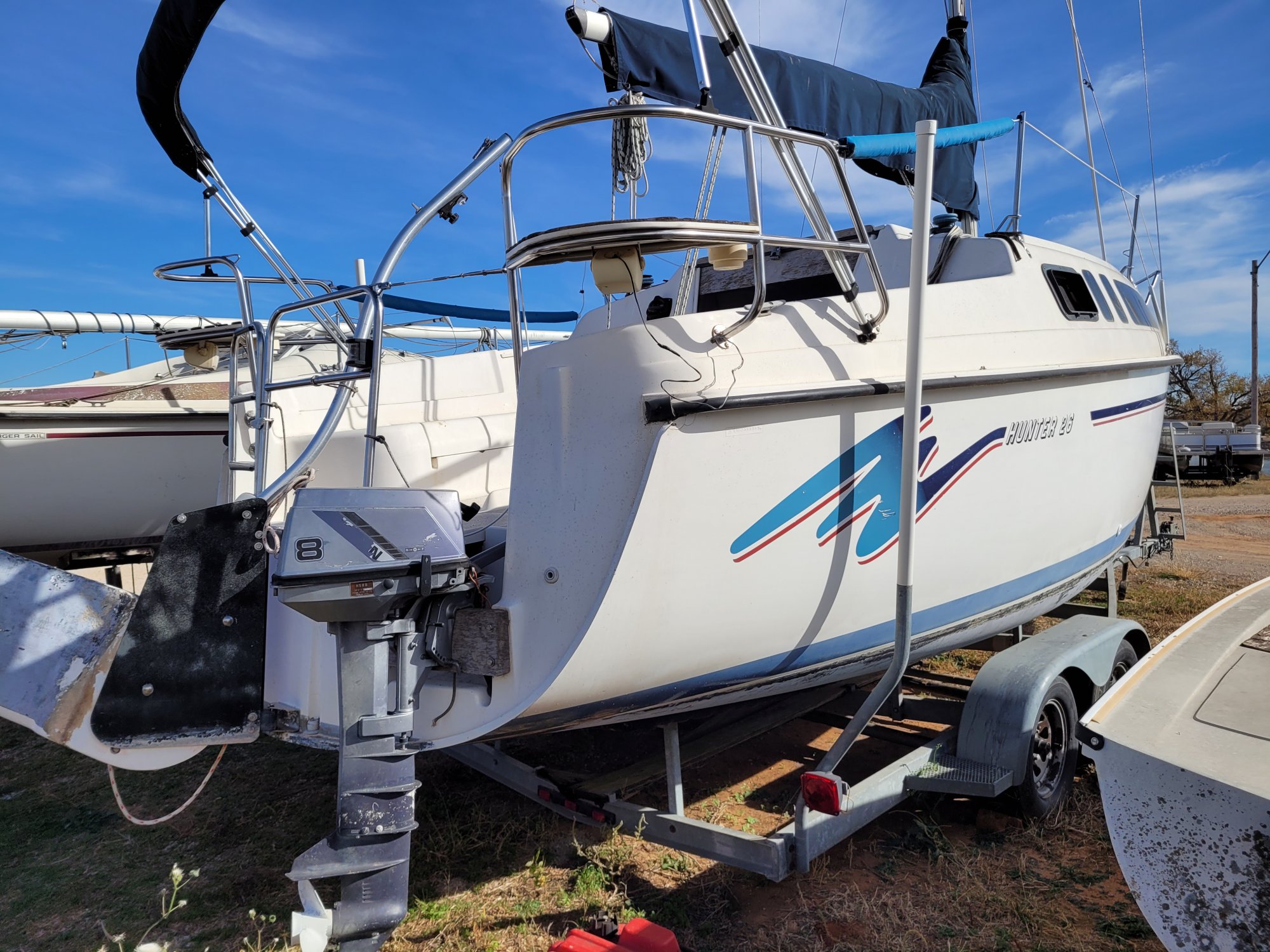

New owner 26h need know the best way to rise the boat off the trailer. Would like to remove centerboard. Be working storage lot out in the open, no travel lift just jacks stands.

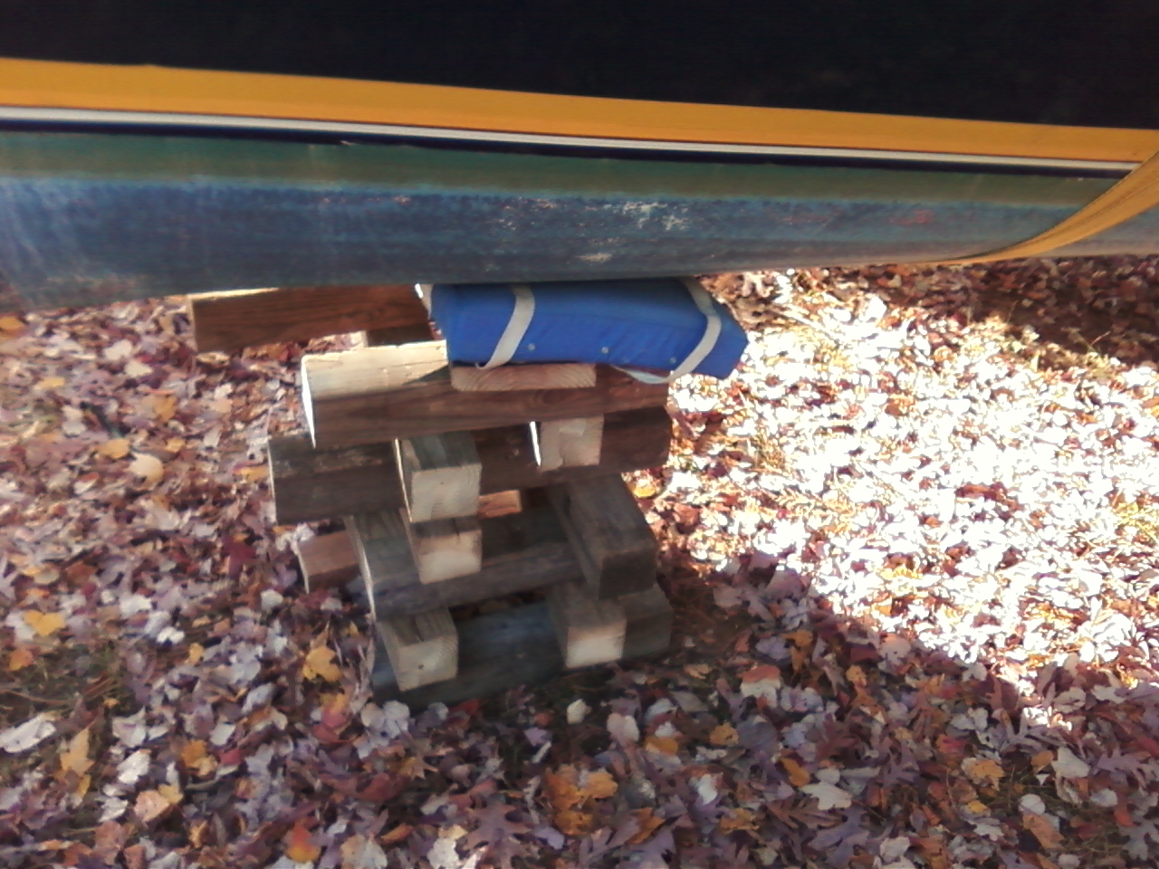

Well I hauled the boat out on the trailer in front of Gustav and while I had it there, I decided I would go for it. Using standard car jacks and the trailer tongue jack, I jacked the boat and trailer up in the air very slowly and evenly.
Then I used cinder blocks, RV jack stands, and wood pads covered in carpet (b/w jack and hull), and built my on homemade boat stands and placed them directly under the points on the hull where the sling locations are marked. Let me say here that these stands actually turned out to be fairly sturdy but I was a little nervous at first.
Anyway, with two stands in the rear of the boat and two stands forward, I proceeded to lower the jacks holding the trailer up. Again, very slowly and evenly. I strapped the opposing stands together just as you would with standard boat stands.
With about 8 inches of clearance between the boat and the trailer bunks I was able to drop the centerboard, replace the line, and re-attach the centerboard. I also used this as a prime opportunity to put a new coat of bottom paint on the boat.

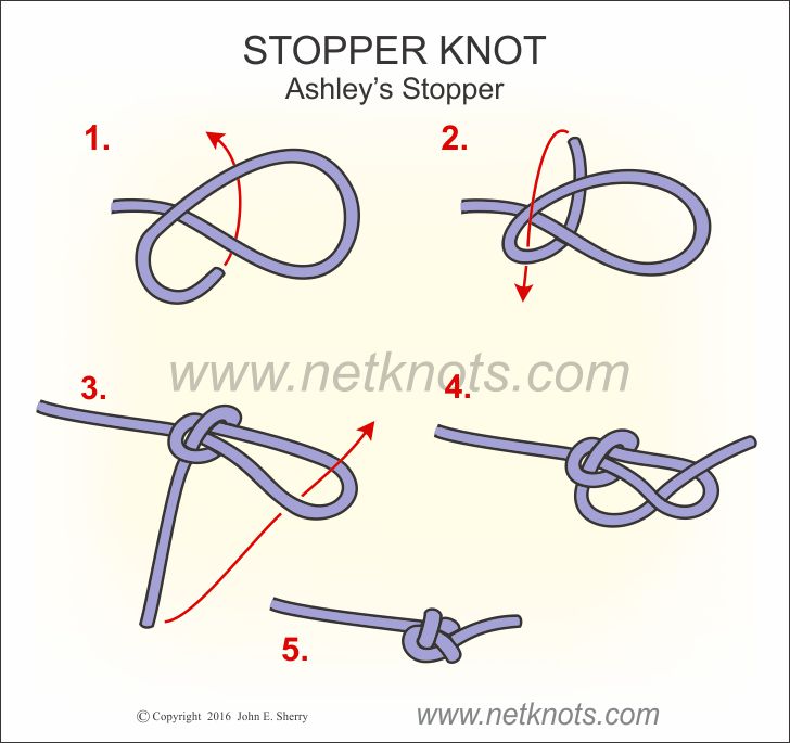

Here is a question concerning the stopper knot in the centerboard rope. Is there one that is preferred over another? This is one that I have used before.stopper-knot.jpg
12,776
So the thing about a good knot is that it does the job without pulling out and without pulling to tight that you can't ever undo it later without having to cut the rope. In this case, it hardly matters. If (when) you ever get around to replacing this line again, you are going to cut the head off of the knot. So you just need it to not pull out and not get in the way of the moving parts.

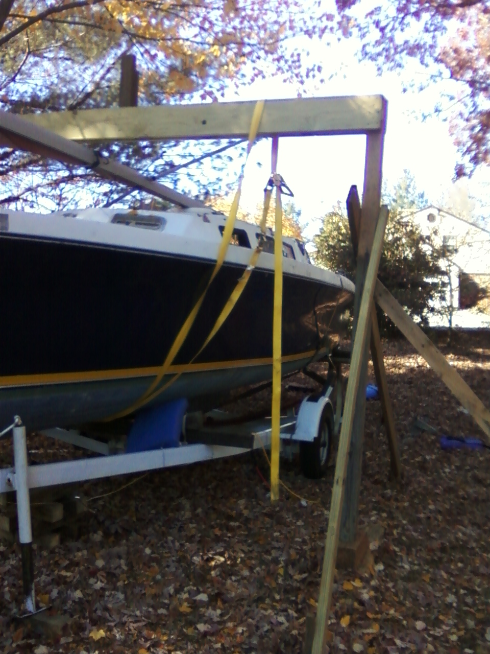

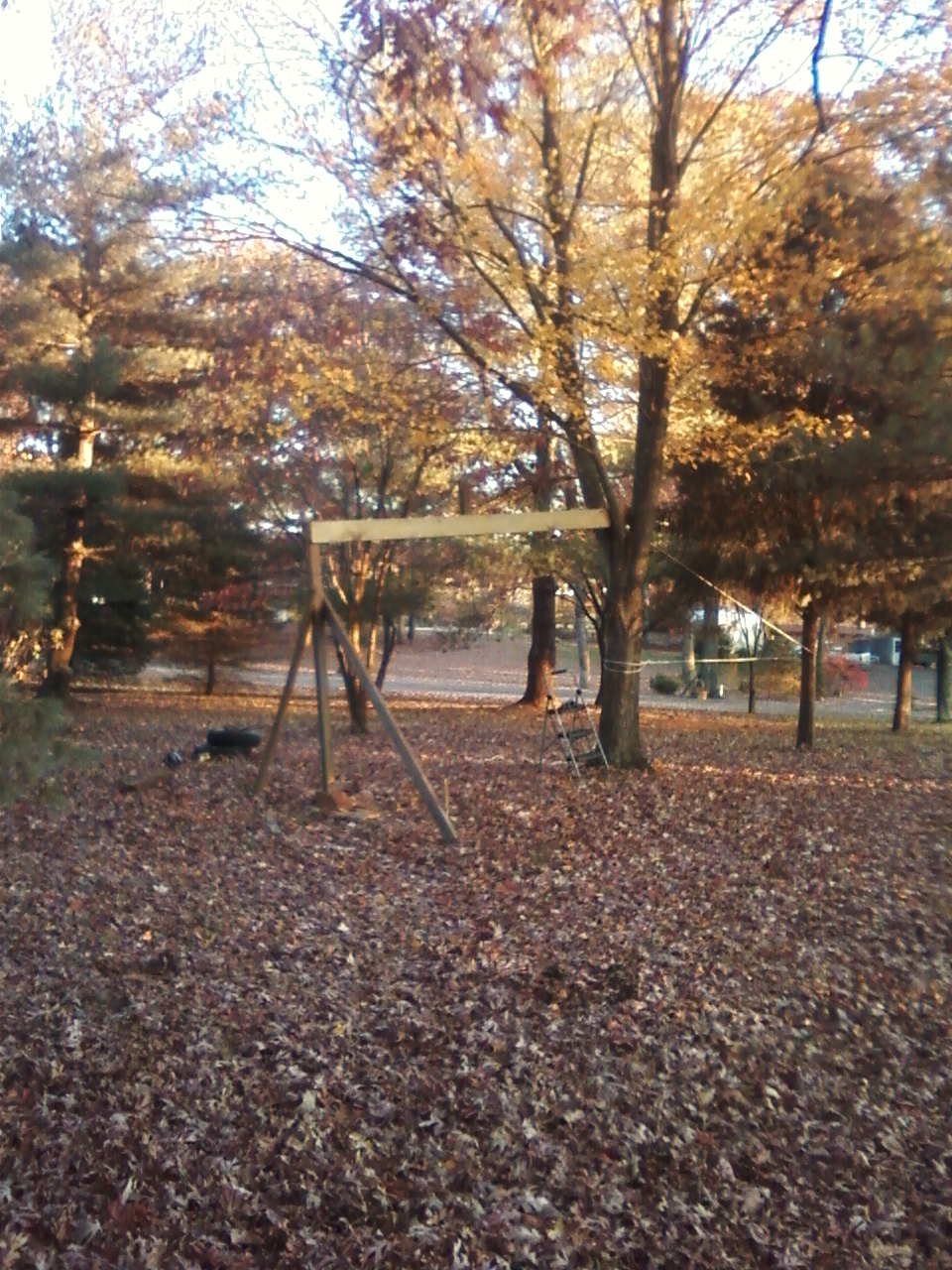

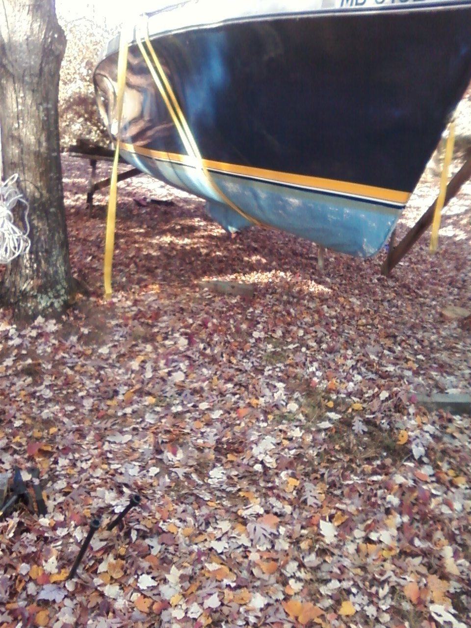

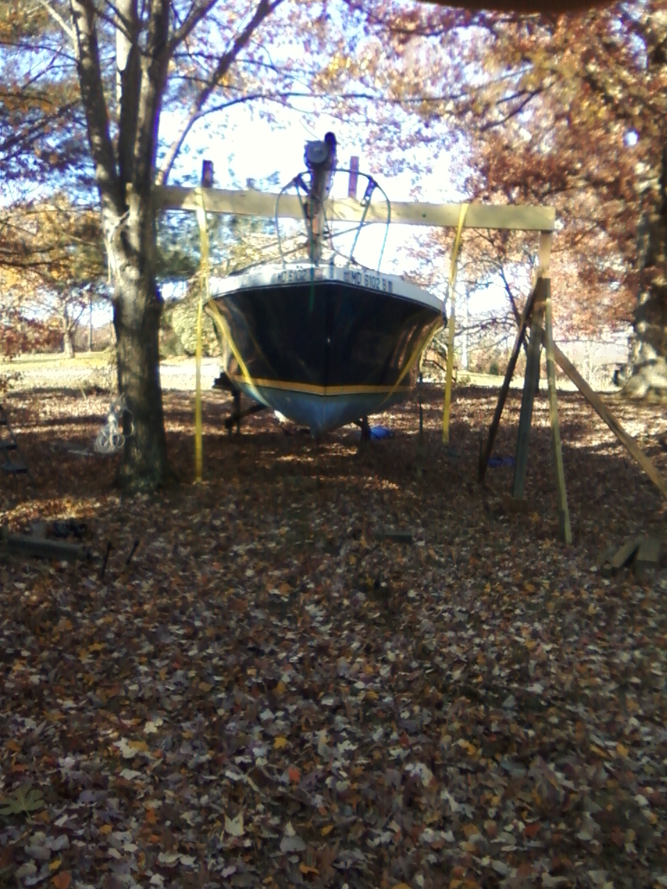

That gohoist is cool. I sort of made my own-ish...
I inched the boat off the trailer using the ratchet straps... when the ratchet block would get full of strap, I would block the boat in a few places and reset the strap and start again. It took a while but a few inches at a time and eventually I was able to pull the trailer out.
It would not be hard to fabricate one but it might be worth seeing what the commercial onces cost.
@rs1sensen 's idea of a boom truck is a good idea. I've rented a lot of heavy equipment in the past and it surprised me how inexpensive it was. For instance last summer I rented an excavator for the weekend for $350... (or $150/day). It would cost you more in materials to make your own go-hoist.

If using straps under the hull. Tie them together so the straps will not slip out.
Also I would suggest screwing another board as appears in Rgranger photos to ensure no bending of boards.
12,776
Dave is right, you cannot see it in the picture but there are actually two 2"x8" joists screwed together with 2"x4" spacers.

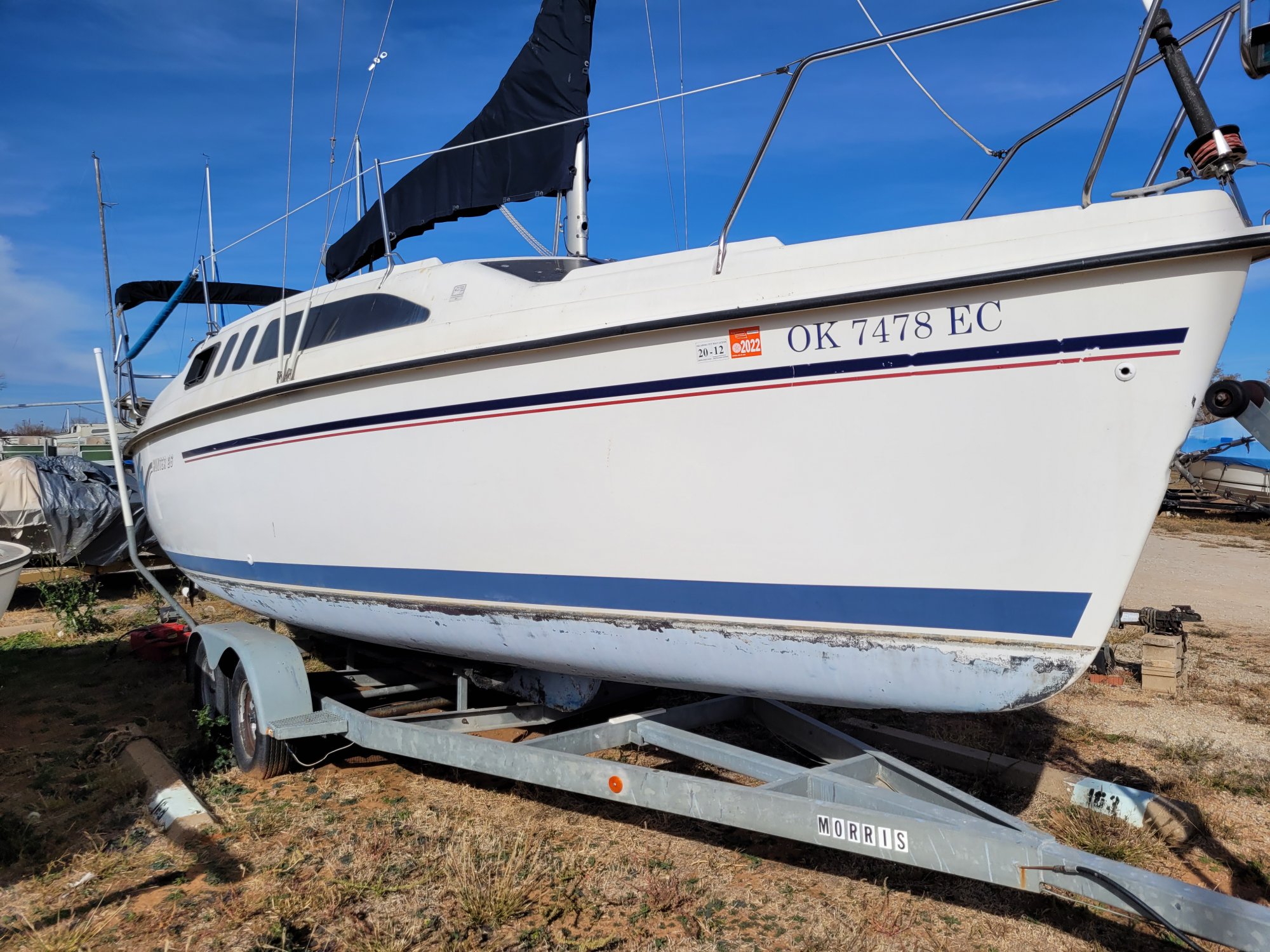

Thanks for the response, still haven't made up my mind on the best way to lift it off the trailer. This is not my first sailboat but at 73 it may be my last. l like having projects but I'm working a lot slower, this is a1996 hunter 26 WB. It needs a lot of cleaning been setting for the last 3yrs. Basically clean, bottom paint and a little bit of touch up fiberglass work. Now as I check thinks out, the mask where the pole for lowering goes looks a little elongate, is there a fix for this? I'll try take some pictures of it next time.
