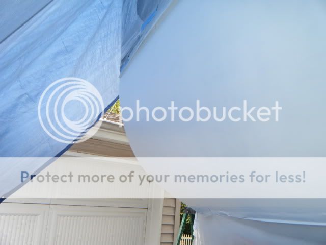

Well, as usual, I didn't have the foresight to take a picture of the specific issue at hand. I did have a few from the boat, before and after varnish. I've got one more coat to do on it by the way. And, the owner stated his wishes to me about removing the awlgrip while on the phone, so I haven't photo'd it yet. I usually take pictures of all my jobs, before and after for several reasons. So, the first picture you see has just a touch of the awlgrip on the very bottom, which coincidentally happens to be a before pic. I think the rest are afters. The guy must like the work, he keeps throwing more at me..

Oh yeah, now that I look at it on the big screen, you can barely make out the rubrail in the second picture. The first pic is sideways, I'll never figure out how to manipulate photos..
