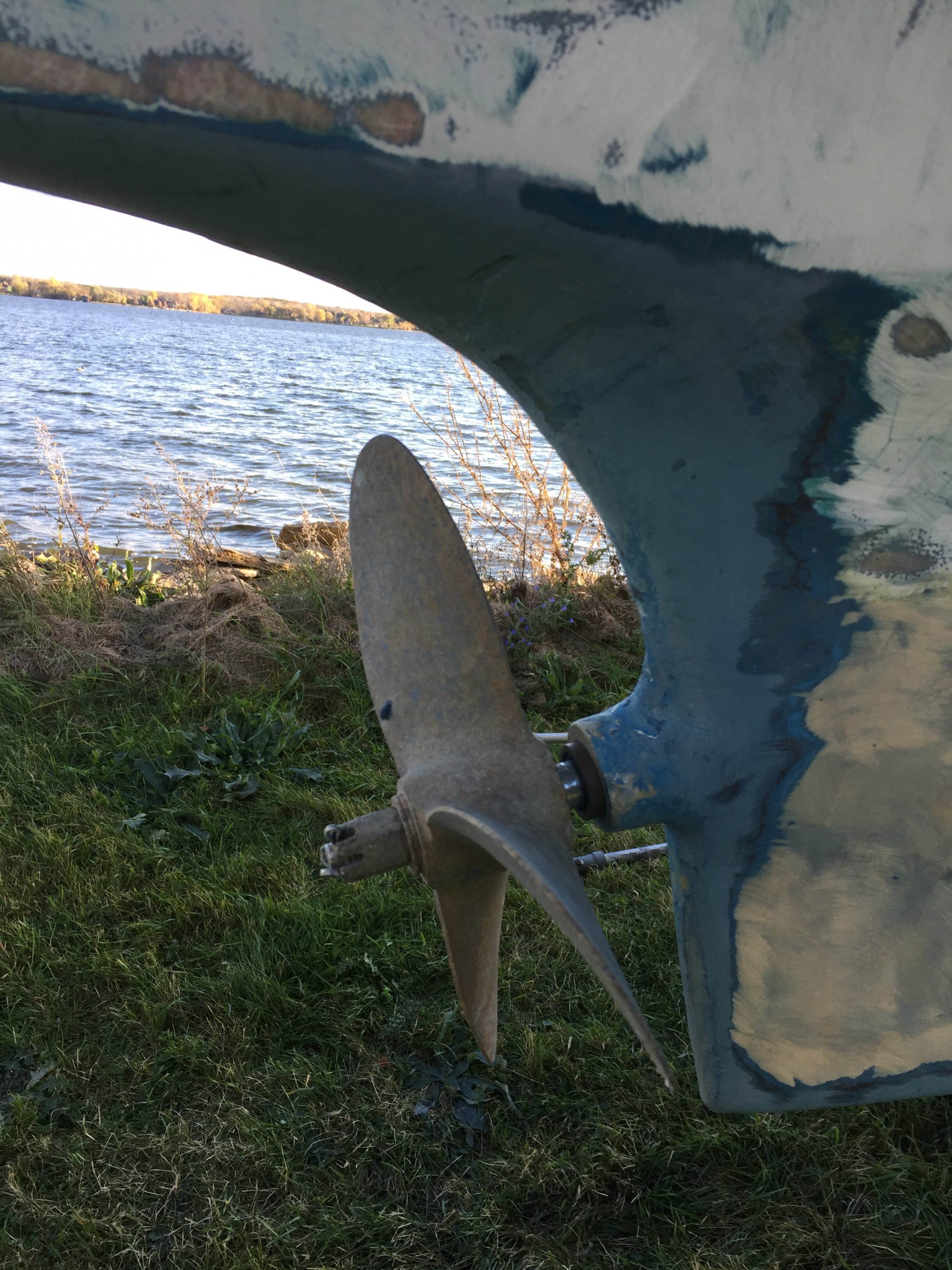

I have had the delightful chore of sanding 25 years of antifouling with a drill and sanding pad. I've removed most but have not tackled the tight curves e.g. leading edges, hull to keel area. I've considered using a chemical remover. Is there any other way besides blasting or using elbow grease?

A drill and sanding pad can get way closer than the photo seems to show. Edge it (holding the disk on its side or at a steep angle.) but be careful not to dig holes. This assumes the backing on your sanding disk is a bit flexible. Other options in limited locations are drum sanders in your same drill. Another option is a flapper disk attached to a small angle grinder.

In another question I posted I noted that I was aware of personal and environmental concerns about sanding and therefore took precautions. Obviously should have done the same here. No other boats were effected, the environment has not changed and my life span hasn't changed :)
I was only looking for advice re tight curves. But FYI I fount the random orbital sander heavy and less precise than the drill.
I just tried scraping the outside curves and it seems to work well.
