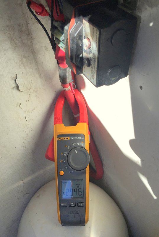

Your alternator belt drives the fresh water pump on the engine if you physically remove the alternator the engine will overheat.protecting from a BMS load dump needs to be done very carefully and a starting battery can be kept as a buffer., How this is wired is critically important. Be aware that many of these drop in lithium batteries are not designed to start engines. You can destroy the BMS inside them by doing so. Be sure you have batteries/BMS that can handle the inrush current for the starter motor. The inrush current can be six times what the average cranking current is.please read the specifications on your lithium batteries very very carefully. Also be aware that if your batteries are not ABYC TE-13compliant, and many are not, or you may not be insurable
this customer destroyed a drop in lithium iron phosphate battery using it to power his windlass

The battery can output 900A peak, then approximately 250A for one minute and 150A continuously.

Thanks you both so much for the reply. I wasn't sure about the belt driving the fresh water pump (not being at the boat at the moment). The battery can output 900A peak, then approximately 250A for one minute and 150A continuously. With that in mind, is there a way to disable the alternator?
