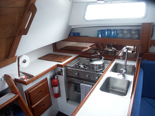

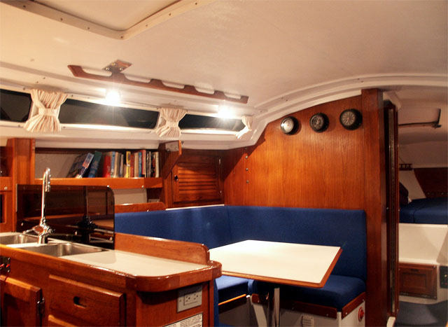

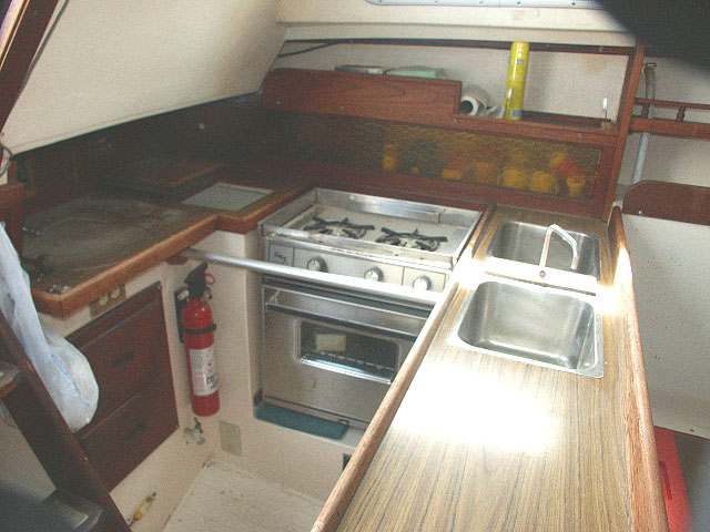

Mine was not glued down, screws only but a lot may have changed in the 3400 boats between yours and mine. I found screws under the edge of the cabinet face as well as from underneath with the drawer set removed and in the aft edge accessible through the port cockpit locker. Mine was not a destructive removal. The pics are before and after, same countertop, new laminate.

Thanks Neil; after the upside down ones into the cabinet (had to remove the stove), the set in the locker was the final trick - sneaky.
You did nice work! How did you conceal the wiring for the galley stove work light?
Rob
880
Fed up w/ personal attacks I'm done with SBO

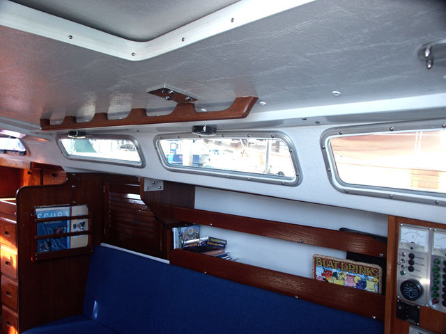

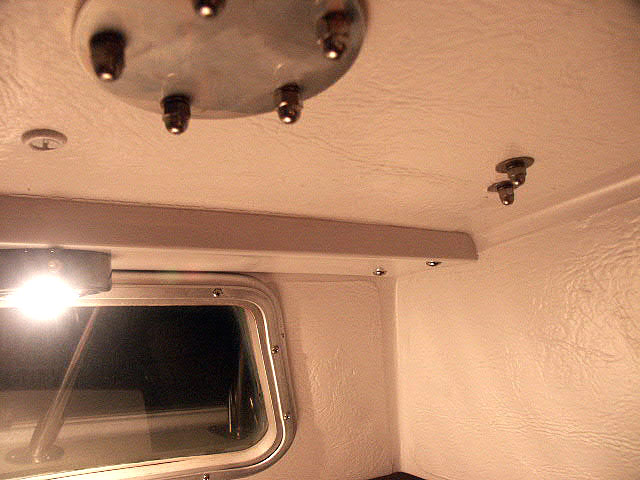

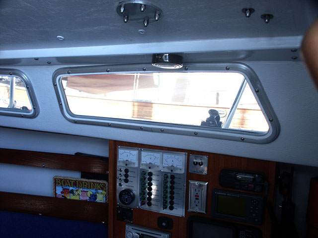

Thank you Rob. I made fiberglass channels that run the length of the cabin on both sides. They blend in pretty well, provide wiring concealment and a mounting surface for the light fixtures.
It was a tricky project involving molds to fit the curvature of the cabinsides and camber of the deck. Also cutting the compound angles on the ends was challenging.
