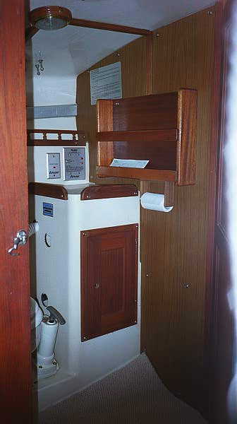

I do have a picture of my head saved on this computer so it kind of shows the switches back on the wall. Don't know if this helps at all, but thought I'd include it anyway.
