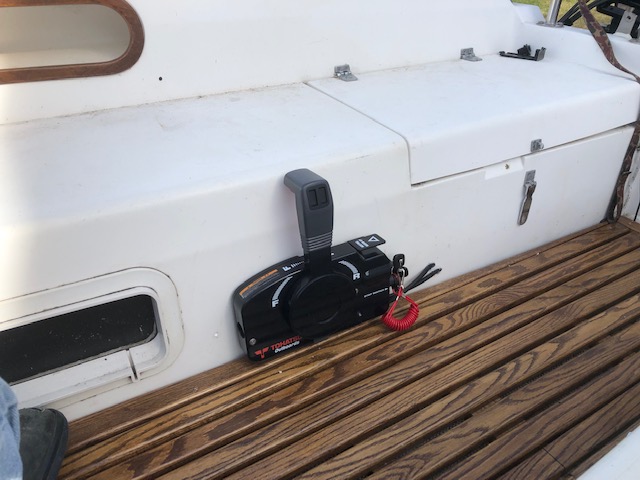

Other than that, the rest went fairly smoothly. The remote box was mounted on the starboard side of the cockpit foot well.

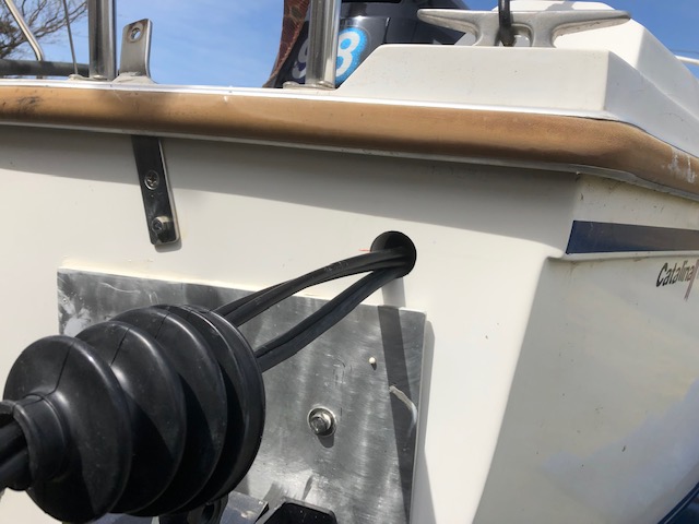

A 1 1/4" hole was drilled in the transom to allow the cable to pass through. I used a CV joint boot to cover it.

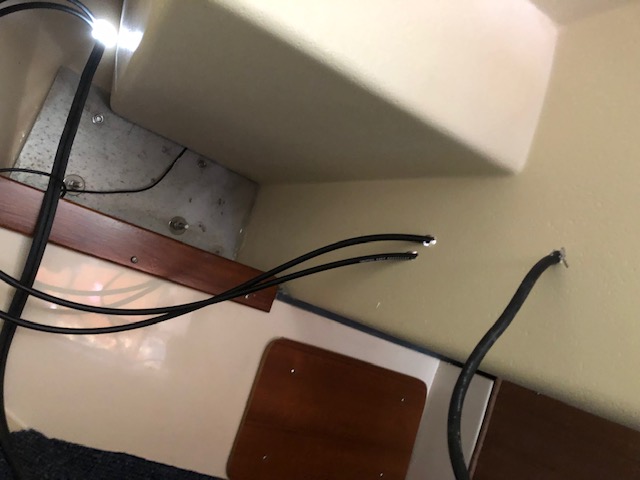

The cables pas through the foot well wall into the rear bunk area, then out through the transom.

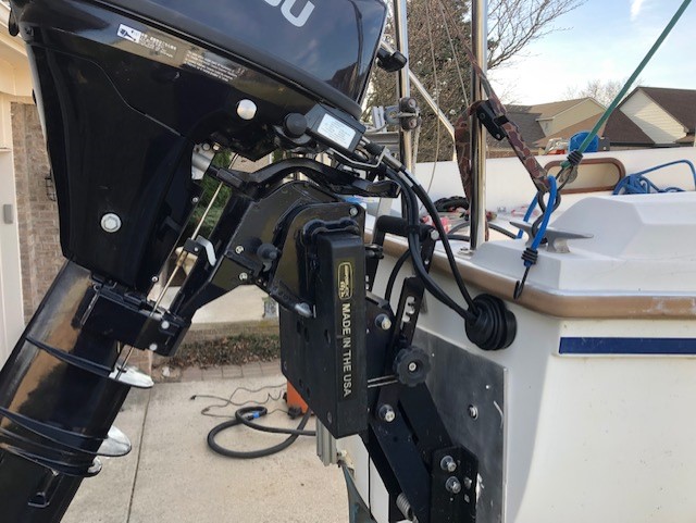

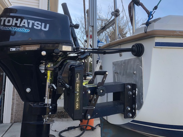

Motor shown in the operational position, fully lowered:
Motor fully raised and tilted up.
