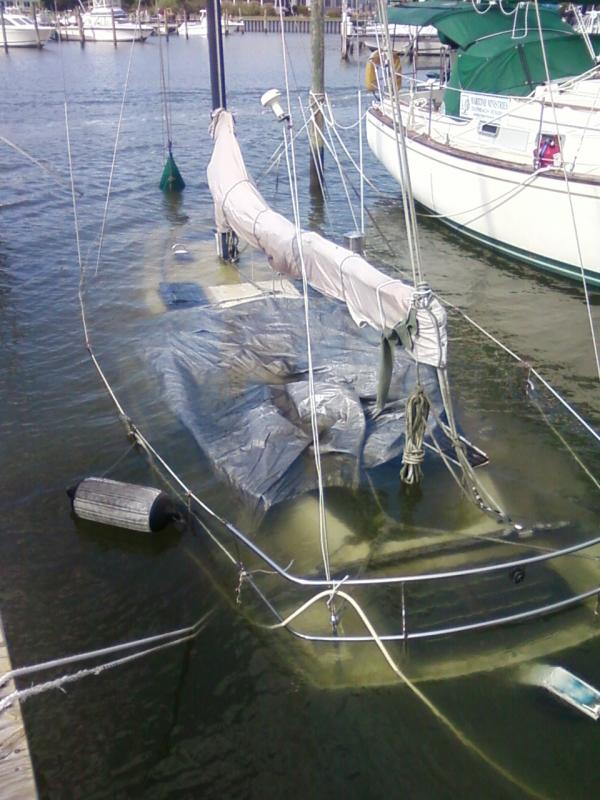

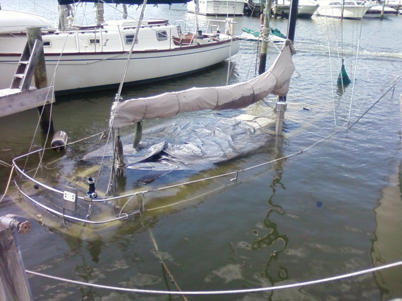

Just a reminder to check your bilge pump & close your thru hull valves before you leave your boat. This boat owner at our marina didn't. Actually, after talking to the owner, he knew his bilge pump wasn't working right & didn't fix it. So his boat & his wallet will now suffer for it. Luckily he did have Boat US insurance. But after talking to the salvage company, it will probably cost around 10 grand to float this boat on air bags, pump it, tow it & haul it out.
Likely a totalled sailboat. I felt bad for the owner. Its a sad sight, but completely preventable. I kind of wondered if this neglect was intentional, but I don't think the insurace company is going to give you much for boat that's been sunk, unless you have an agreed upon value. Guess we're all one bad leak away from witnessing this.

I'm not following your comment that it's "completely preventable." You never said what caused this boat to sink. Was it a broken hose on an open seacock?

Sorry I've been busy at work & couldn't answer any questions, of which I knew there would be some. The owner of the boat was informed recently that his boat had started taking on water. He had pumped this boat out before due to it taking on water. That's why I don't understand why he didn't fix the problem properly, or haul the boat out while he had a chance. I suspect that the engine wasn't running. It has been sitting in this slip for years with little or no maintenance. The boat actually has had some maintenance at some point, as it had a newer solar panel & self tailing winches installed.
I do feel that the owner was given notice about his boat taking on water, & obviously didn't do enough to correct the leak, & didn't even replace his bad bilge pump.
So he got what was coming. That's why I started to wonder if the neglect was intentional, to get insurance money.
But honestly the point isn't really just this boat in particular. The real point is that we are all just one bad leak away from being sunk in the slip ourselves. Boats on a mooring or even more at risk. That's why I always close ALL thru hull valves, & check my bilge pump on a regular basis.
