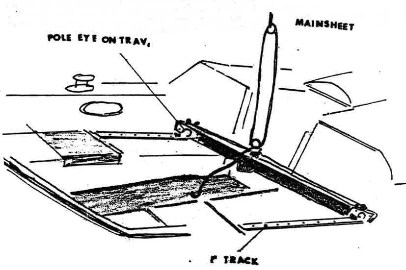

Here's a clever idea from a Tanzer 22 sailor. He put his traveler on a set of fore-and-aft t-tracks so he could move it to the front of the cockpit when cruising and back to the standard position when racing. I clipped this from the T-22 website:
MAIN SHEET FORE-AFT TRAVELLER
Rudi J. Harbauer, Freeport, N.Y., no. 1170.
In seconds, your T22 can be converted from a cruiser to a racer without losing either performance or convenience.
On a beautiful day this spring, I singlehanded in the Atlantic Ocean off Long Island. There was a Steady 8-10 Knot breeze . . . just perfect for a spinnaker run. I don't have to tell anyone who sets a spinnaker alone, the type of work involved. I got it flying okay - but climbing over the traveller constantly was too much. I considered elimination of it altogether, but hesitated since I race the boat a lot. This problem had to be solved another way.
First came the consolidation of all movable parts onto the traveller horse. Second was the installation of two pieces of 1-inch track from cockpit locker to companionway. Third, 2 pole eyes (1-inch) were welded on a bronze plate and fastened to the traveller horse. Fourth, an additional track on the underside of the boom with a pole eye allowed the mainsheet to be moved.
After 6 months of cruising-racing, as well as single-handing, I can report that we are a happy sailing family. It works just great!

That's my solution!
I replaced the original traveler this season with a new Harken bar and 22 mm End Controls with the built-in cam cleat. AND I already have two 2-ft long pieces of new 1" T-track. The only thing missing is a way to connect the traveler bar to the track. that should not be too difficult. A winter project that will be a delight to use next season!

I finally got a chance to look at the dimensions for relocating the traveler.
Using tracks to slide the traveler forward to the cabin would need 48" tracks. It would also mean the mainsheet attachment would be moved to mid-boom. A good idea in thought, but not so effective in execution.
Moving it back to to the stern is the best since the non-racing version uses that configuration. I would like to have a quick disconnect for the mid-cockpit position so that I can relocate the traveler when my wife sails with me. Most of the time the mid-cockpit position is fine.
The Harken traveler with the integral cam cleats lends itself to be reposition-able if only there was a quick release for each position mid- and rear- cockpit.

You really don't need the continuous adjustment from a 48" track. You could put a small section of track in the normal position and another one in the cruising position.
507
Catalina 310 278 Lyndeborough NH
If I procrastinate long enough, my wife will "adjust" to the traveler as is.
The partial tracks solution resembles my idea for a quick-release mechanism. I would like a quick-release mechanism and alternatively move the traveler to the stern to avoid changing the location of the mainsheet force from the end of the boom to the middle.
