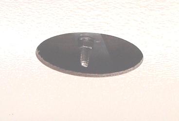

H
Howard
Backing Plate
The Pic looks great. What kind of backing plate did you use on the underside. How did you deal with the fiberglass headliner on the interior? Inquiring minds want to know Thanks HN
G
Greg Garner
Backing Plate with picture
Cut a hole in the liner. Used threaded SS rod with washers top and bottom. The back plate is 1/4" x 1" X 8" stainless plate with two holes for the threaded rod. The angle stainless is 8" long to distribute the stresses over a greater area. Also, the stainless runs starboard/port, not for and aft. (I did this to allow for the installation of a double clutch on the starboard side. I am going to take a better picture of the liner and post tomorrow.
