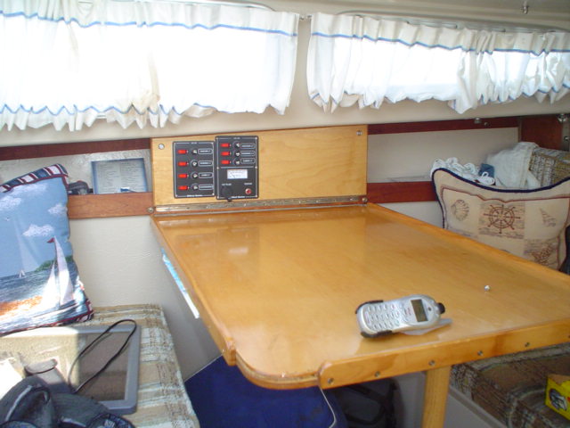

So as I have said in my other posts, my old electrical panel was not working. Many of the wires were not useable so I thought I would relocate the pannel to a better spot. I chose this location after seeing something like it on the C-22 assn website. My goals were to get the panel and its swiches to a easier location and to add a battery monitor. In addition I wanted better swiches and an accessory plug for charging stuff or using my laptop at the table. I also wanted to leave enough room for a later stereo and VHF. The picture shows the table I built and the new panel with room for more stuff. I have also located a battery switch where the old panel was as well as two new batteries. Now I have to get the running lights and depth sounder working and all will be well. THis is my first big project. Let me know what you think. Art <(((><

Here are more pictures. If any one would like templates or dimentions let me know. This was not a hard project. But it was fun and more user friendly. By the way the whole pannel is hinged and folds down for repairs. Art <(((><
