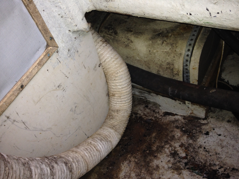

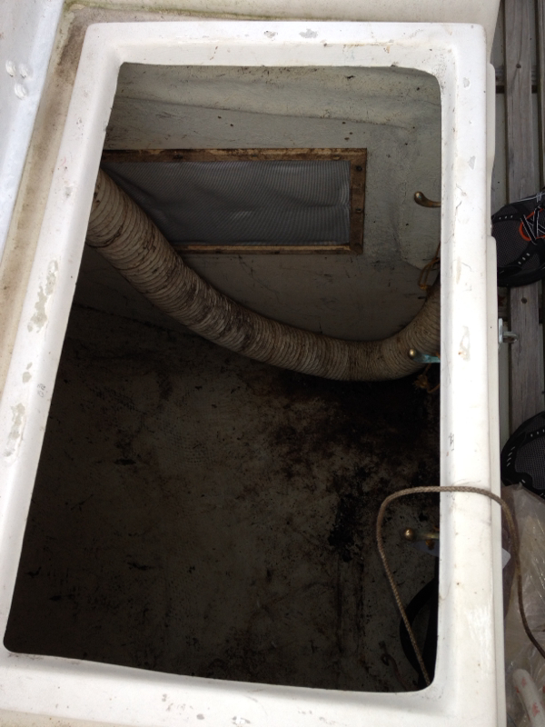

Hey gang,
Would relocating my batteries out from under my companionway steps and to the starboard lazarette be reasonable? I have to rebuild my steps and moving the batteries would improve the floor space on the main saloon on my ODay 27.
I have two 6v Trojans and one marine start battery. I'd have to build a shelf/box in the laz for them. Concerns are the batteries not being dead center-- possible acid spillage, and possible boat listing. Third concern is the aluminum fuel tank in the shared space between the two lazarettes.
Here is a basic photo looking into the lazarette and a photo of my fuel tank, for visualizing what I'm looking at.
What do y'all think? Reasonable ideas?

Oh, if I built a shelf we are talking about just the right depth to be able to reach down to service the batteries. Not too deep to make servicing the batteries an accidental Houdini act (no need to climb into the lazarette).

I expect you will induce a list, and raise the bow. You could demonstrate this with a few bags of play sand stacked up in the desired location.

If you are moving the batteries from a centerline location to one of the sides you may anticipate the boat will tend to list to that side unless you add counter weight on the other side. If you are extending the round trip distance of the battery cables then you might need to move up to a heavier gauge wire (consult a wire sizing chart). batteries do need some ventilation to dissipate gases so make sure the lazarette is not air tight. I would assume you may be talking about diesel fuel as the batteries should not be in the proximity of a gasoline tank.

Yep, its a gasoline engine. Drat, but that's why I wanted to include the photo of the tank, just forgot to mention its a gasoline tank! :doh:
I don't think my settee storage areas are deep enough for GC batteries, looks like they will need to stay where they are and rebuild the steps around them after all.

The other point Benny brings up - heavier gauge wires - might also have given you pause. Battery cables get REALLY expensive when they start getting longer and heavy-gauge. That's why they generally put the batteries as close to the engine as possible. They also put them down as low and as centered in the boat as possible in order not to interfere with sailing performance. Putting them in the lazarette would probably have messed up how the boat sits in the water and slowed you down considerably, besides adding to any hobbyhorsing you'd do in wake or waves.
