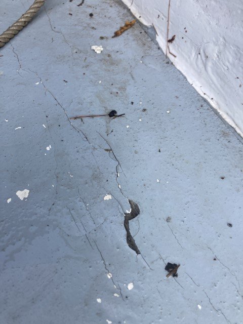

I keep her on a lift at our club, and have been sort of mystified as to why the floor seems to be erupting. As in pics, the paint (and maybe even glass?) basically rips open in cracks, I assume from moisture escaping the bilge. The entire cabin sole looks like this mind you, not just a few spots. I've tried leaving the bilge drain open and closed, and I think it's worse with it closed, but I haven't been able to stop the degradation. In general my boat also feels heavier too; I'm guessing most of the sole's marine plywood is saturated, and perhaps part of the delaminated parts of the bilge.

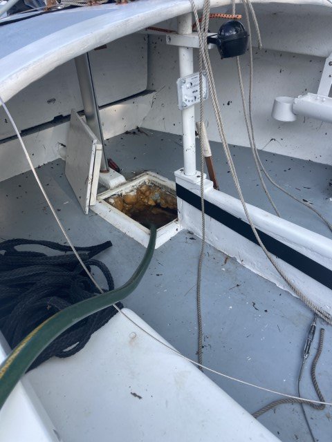

I've scoped/peeked in the square access port (pic) and it also looks like some of my stringers are basically non-existent, save for portions of the fiberglass that encased them, which are still partially standing.

typical cracks through sole exposing delaminated plywood
above is the access panel for the bilge

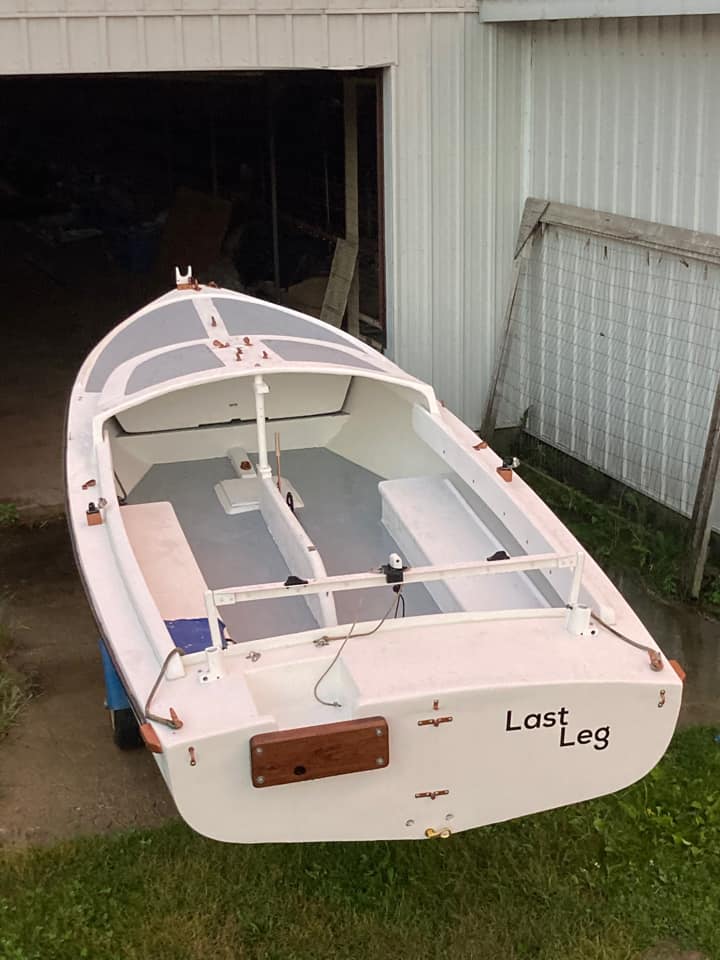

after a fresh renovation and paintjob 3-4 years ago
