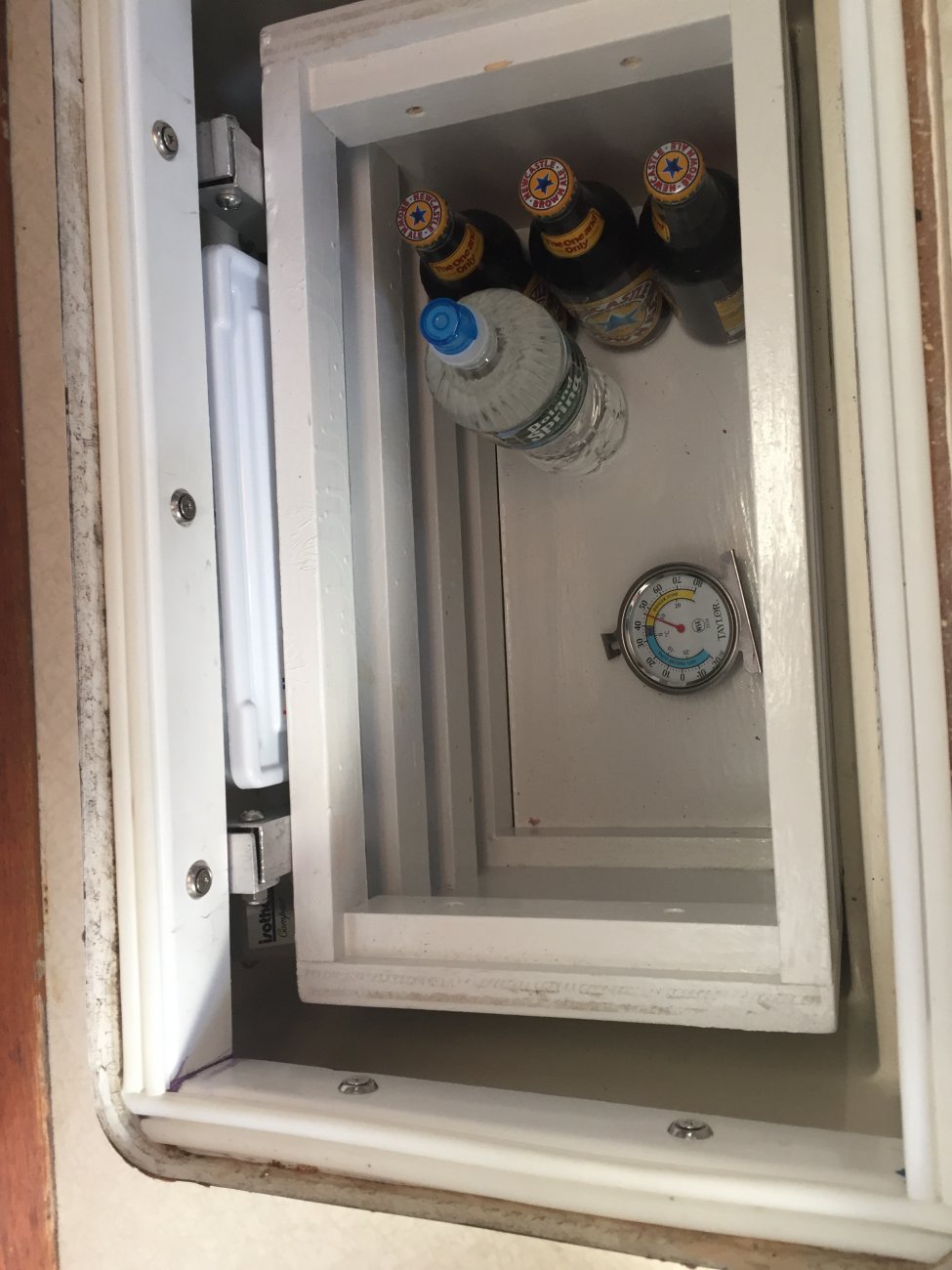

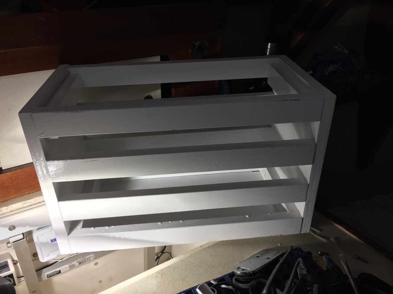

My boat is a different model, however, many ice boxes are similar. If the box was built for ice it quite likely is top opening and deep. Great for ice but you cannot just fill a refrigerator from the bottom to the top with food because you will never retrieve food on the bottom without emptying the whole thing. I built two crates that stack (like milk crates) with guides that hold them steady inside. If I need something from the bottom I lift out the top crate and reach down to the bottom one.

I installed an Isotherm 2501 Compact Classic Air Cooled Refrigeration Component System with the DB 50 compressor. Located the unit on the top portion of the frig. I located the compressor next to the AC unit with a vent into the cabin. This leaves a 6-8" gap aft of the evaporator in the frig for keeping things very cold without freezing. This setup is good for 2-3 day trips. For longer trips I put an insulation board between the high and low sides of the frig turning the smaller side into a larger freezer. I also have a top cover for the freezer section as well. remember to put holes in the vertical insulation to keep the lower part cold. I have 6 1.5" holes.
As for energy use. I have two GP 31 batteries and 180W of solar and haven't had any power issues. I have two marks on the thermostat one for normal and one for motoring. I crank the temp lower when motoring to super cool the frig saving on the batteries.
