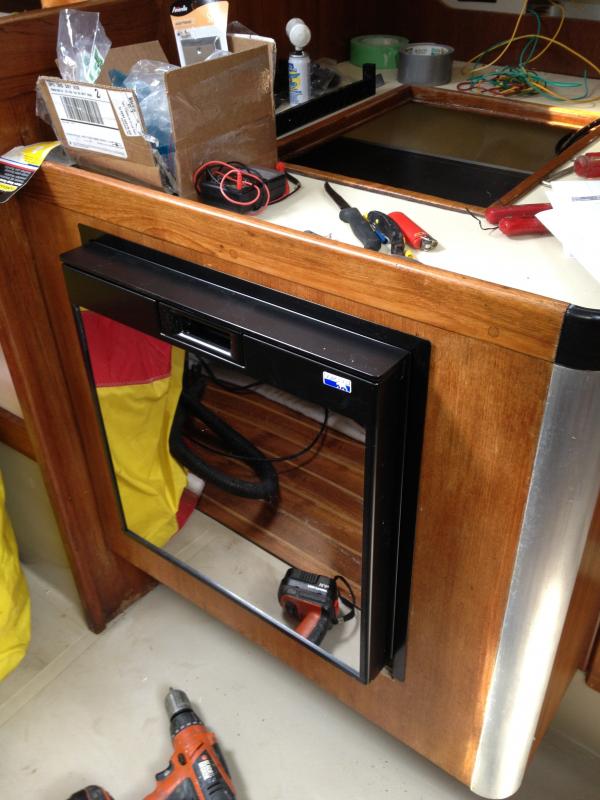

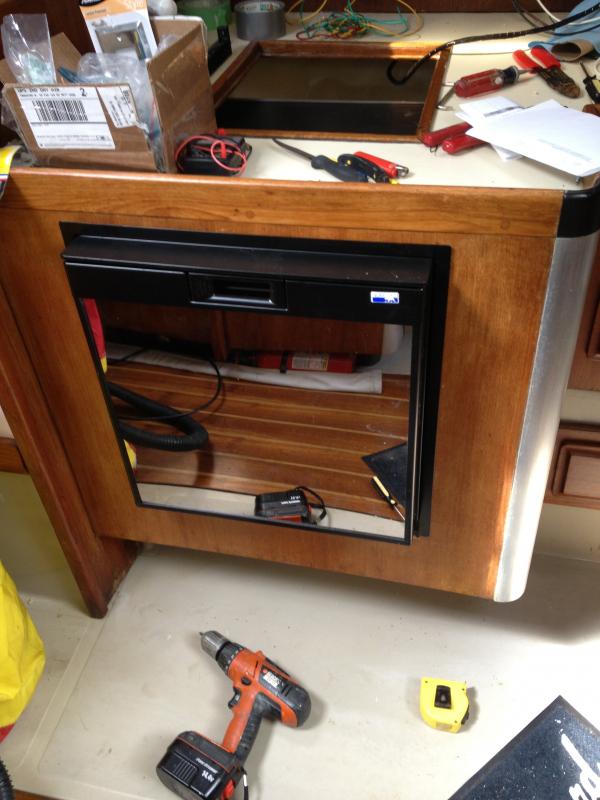

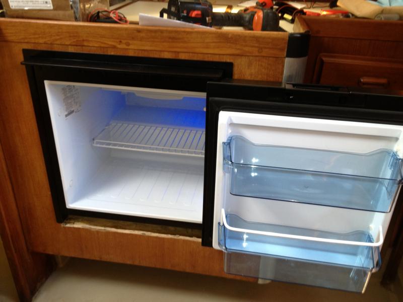

I installed a refrigerator on the starboard side just across from the sink.with the door opening toward the galley. It's a Norcold 12/24 120/240 I'm very happy with it . I replaced the decorative panel with a stainless sheet. The location works out great. My boat was sold into the caribbean charter industry. It has an had an extra icebox/ bar in place of the nav station. I gutted the ice box but left the lid in place for access to wiring and the fridge. It also give us a dry area to store charts.
