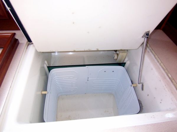

Try West Marine, there are two items that may work if you want to replace the gas strut.
1. "Lid Support Spring"
2. "Hatch Arm"
My 381 had a "Hatch Arm" as original equipment on the Freezer lid and nav station desk lid. I found the replacement item at West marine. I think there are to or three lengths.

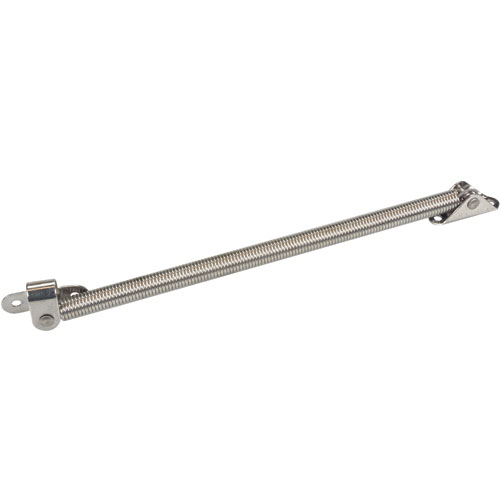

Sea Dog Line hardware
I've seen both gas struts and the hatch springs. Ours has the hatch spring and it is definitely up to the job of supporting the freezer lid. The manufacturer is SeaDog (depicted in TAK's photo). They make at least two sizes of that spring and Beneteau uses both. The smaller version is often used to support the chart table lid. We have spring p/n 321675. Sea-Dog also makes a range of gas struts, so you may find one that fits your mounting dimensions.
Sea Dog Cabinet Hardware
look under "gas lift" or alternatively "hatch spring"
