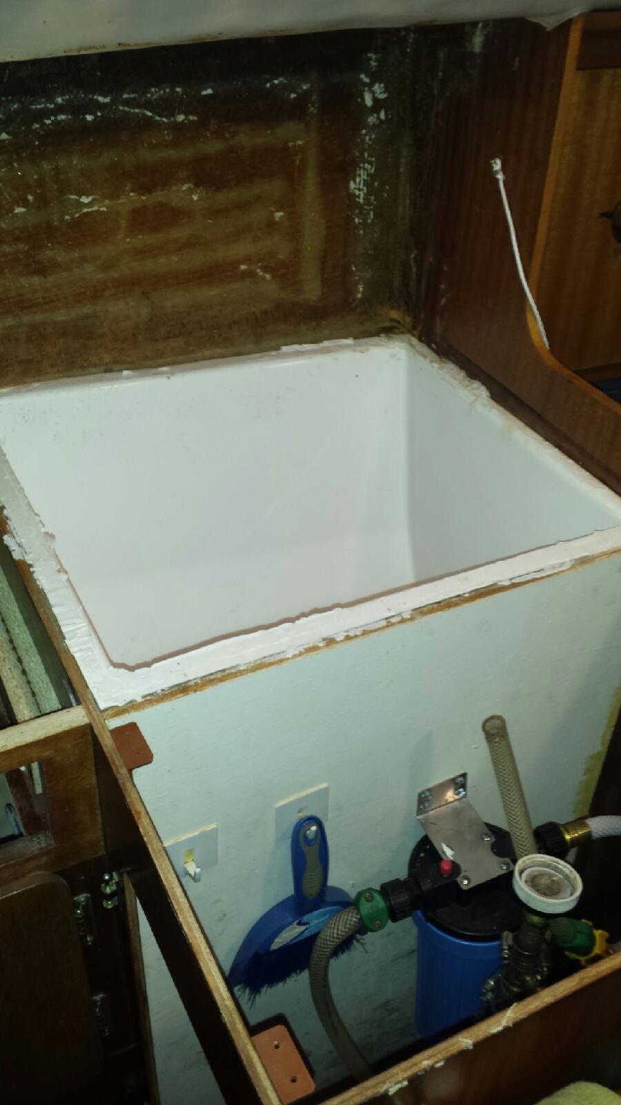

I failed. I took everything apart, realized there was no space for more insulation unless I completely rebuilt my icebox.
I ended up buying a portable fridge and using the icebox for storage.

I tore my galley cabinet out and built a new one with one of the goals being to increase the insulation around the icebox - turns out as JPB said, there's no room to add more. O'Day did a good job of covering the icebox with foam (2" - 3") and it was in good shape so I left it as is. I had to destroy the cabinet to take it apart as there were screws that were inaccessible.

I took another look at the millwork surrounding the frig & I can’t see a way to get it off w/o destroying it in the process. I looked at JBP-PA’s photos and my galley arrangement is did-fervent from his. Later this spring I’ll cut a few poke holes from the aft cabin side & scoot a small inspection camera backtrack there, will let your know what I find.

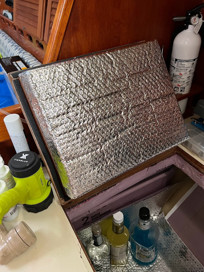

I cut a piece of Reflexite (thin air-filled metallic insulation) to tightly fit inside the top box of my fridge…just lays in the opening (a tight fit so it stays there). It cut down the condensation I was seeing around the frame of the opening and I think helps keep things colder and the compressor running less.

Thanks, that looks similar to what was in my O’34 & it worked noticeably well. Not a total replacement for good insulation, but a significant step in the right direction. I think that a layer of this and new seals will definitively make a difference!

I, too am working on a way to keep cooler temps in our icebox. We have 2 aboard FH, one on the port side and the other on the starboard side. While on a passage from the DR to the Bahamas last spring, I met a marine tech who advised me to line the inside of the icebox with 2" of rigid foam insulation and to tape all the seams with aluminum tape. So, after planning this project all winter, I have begun to line the interior of the starboard icebox with the rigid foam and have covered it with reflective bubble insulation. I realize that this is reducing the interior capacity of this icebox, but I feel that I won't lose much room for beverages for the sake of keeping them cooler.. I would like to find a way to bind the seams permanently, other than the aluminum tape, so that I can remove the insulation like a water tight bag.......

The foam should make a significant difference, less so the bubble wrap (R-1?) as it needs an airspace to get any significant insulation value. The bubble wrap helped on Greg’s boat as did in my previous boat because it is just used as a cover, leaving an airspace above & below. Adding a reflective surface toward the cool side is not going to reflect lower temps back into the frig. Also, make sure your foam is non-hydroscopic, like polyiscocyanurate, so it does not absorb water.
