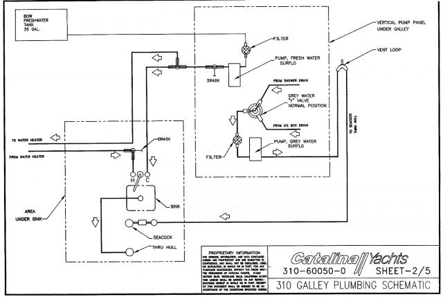

Here is the drawing
From the drawing the ice box and the shower sump are connected through a "Y" valve to the hull valve through a filter and pump. One note is you need to clean the filter out of the hair and stuff periodically. We mostly use our ice box for dry food storage so I have never had to drain it, but it is just a simple matter of flipping the "Y" valve and running the pump.

Rp,
So you drain is from the Ice box and not from the Refrig into the "Y" valve?
Sep 29, 2008
1,954
Catalina 310 #185 Quantico
Correct - Ice Box Trains to Thru Hull
Ice melts and there is no other way to cool the ice box. The refrigerator may drain to the bilge.
