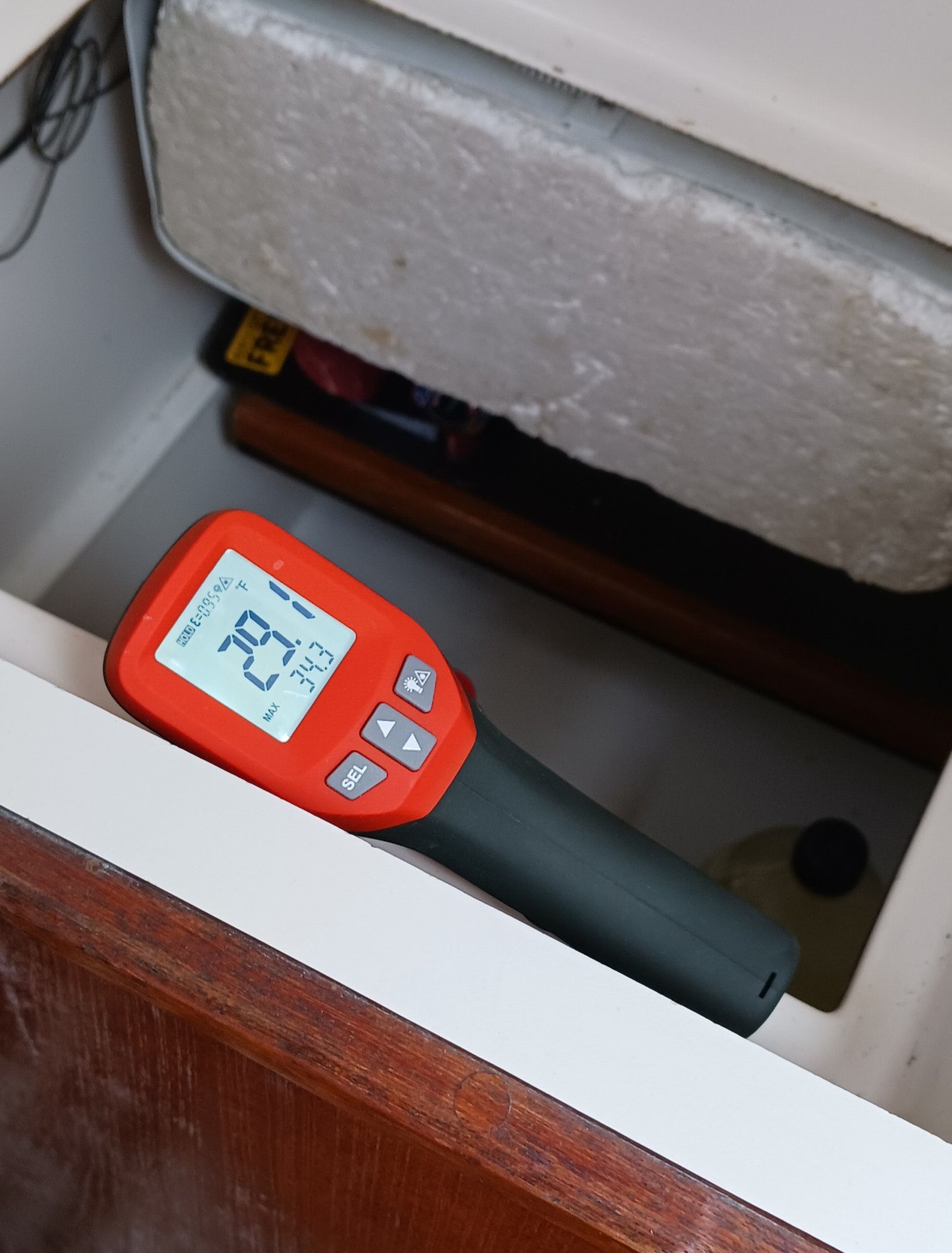

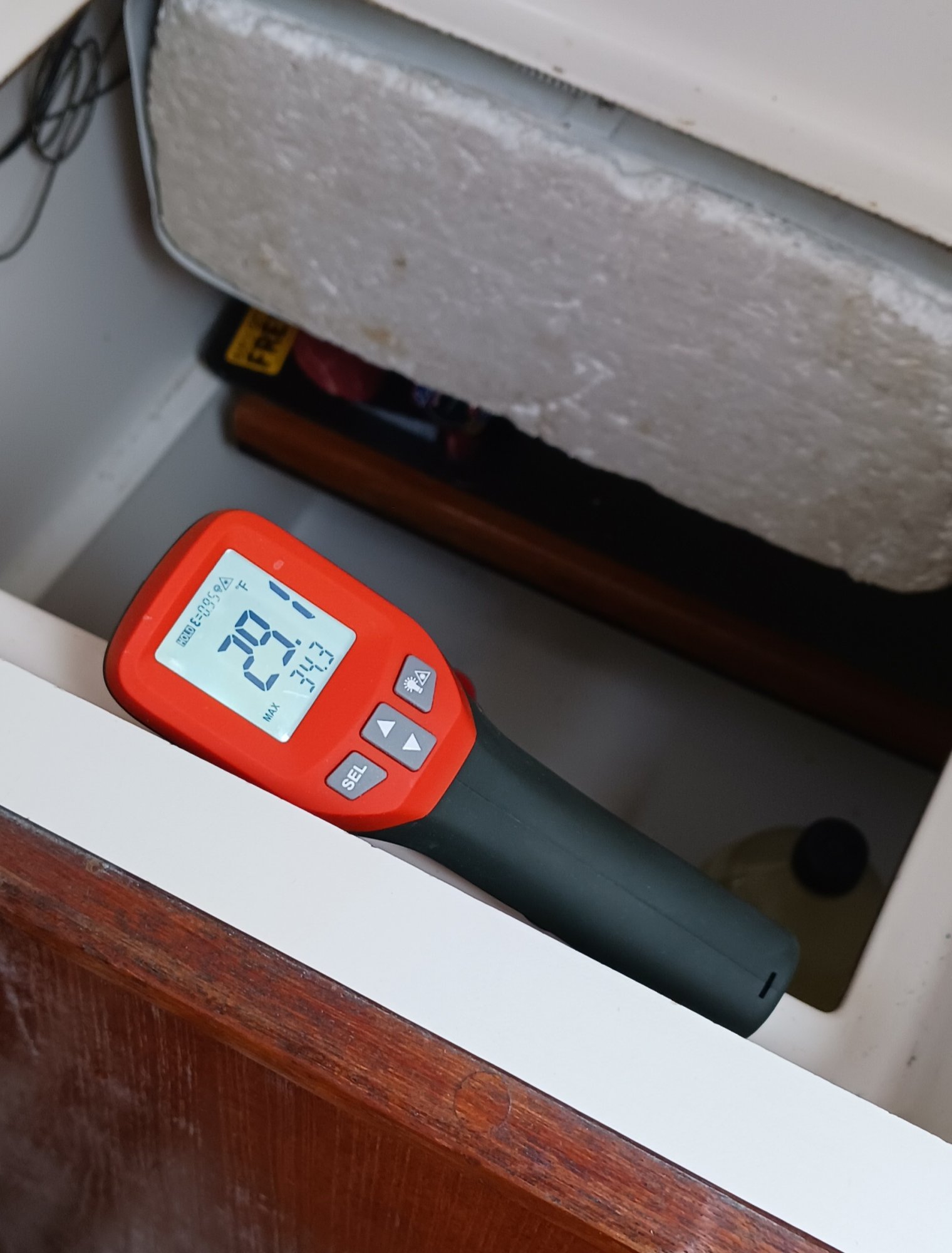

most refrigerators freezers air conditioners are able to operate in high ambient conditions although it is possible if it's working in a stagnant air location like the engine compartment that it will get 200° or so but without information from you, everybody's just speculating.
Typical temperature in the Box on my boat even during the dog days of August on the East Coast with Chesapeake mugginess
