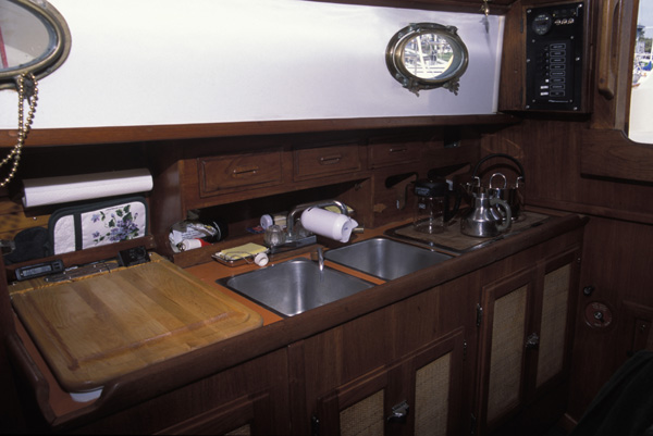

I made a frig/freezer combo...
..for the Endeavour and it is about a cubic foot larger than the EdgeStar and ...
...has a freezer section and is using quite a bit less overall elect. than the EdgeStar, but that is mainly due to the 8 inches of insulation under it, 6 inches on the hull side and 4 inches front, back and top and the 3 inch lids. We used it for 2 months recently and it worked great. I used the Waeco/Adler Barbour Coolmatic 84...
http://www.defender.com/product.jsp?path=-1|406|10789|86418&id=86577
... and the Waeco VD-09 ....
http://www.defender.com/product.jsp?path=-1|406|10789|86418&id=1554195
... evaporator.
These will all use power of course and would recommend at least 100 watts of solar with one. We had 180 watts of solar on the Mac during the trips and in 7+ weeks in the spring ran a gen-set about 3-4 hours total and the solar took care of the rest of the time and we had a lot of computer use also,
