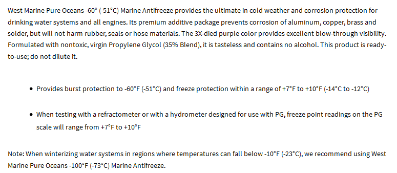

Jerry21707- I don't think you are doing anything wrong. I went to the WM website and found this info on the Pure Oceans -60 antifreeze:
You are measuring +9 which is right in the range that they claim it will read. The rating of -60 is for Burst protection, not Freeze Point protection.

Bottom line:
#1
Use a quality PG antifreeze NOT an alcohol based or alcohol blended product. If it costs less than about $3.49 - $4.00 a gallon it is most likely not a true PG product. West Marine Pure Oceans -50F is a good PG but their Sea Fit -50F is not a true PG it is an alcohol/PG blend.. Be very careful because even Camco, Uni-Guard and many others are now blending PG & ethyl alcohol or selling ethyl alcohol only based "RV antifreeze". Just say no to crappy RV antifreeze!
#2
Test a sample from a fresh virgin bottle & note the reading (-50PG's can vary a bit but none should ever be diluted)
#3 Test each faucet hot and cold, spigots, raw water wash down etc. & generator or engine exhaust and be 100% sure it matches the bottle reading.
#4 If readings do not match bottle exactly suck in more PG
#5 Done
The -50, -60 etc. is marketing "burst point" the refractometer is telling you "freeze point" not the burst point. I don't know of any tool that can measure burst point so DO NOT DILUTE!
