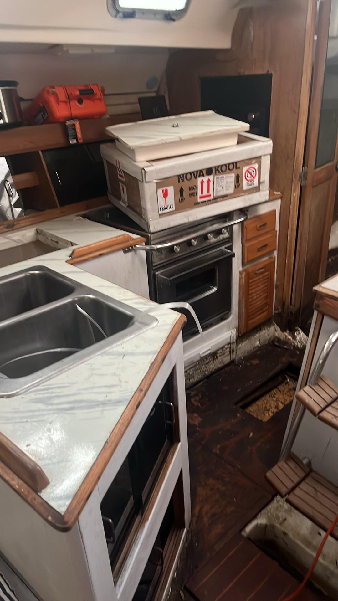

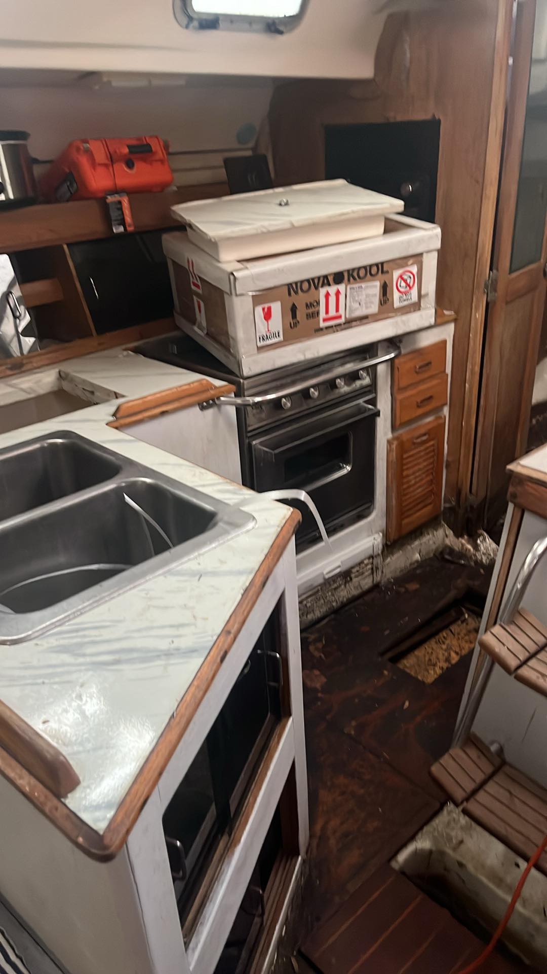

Seems from the photos that you already have the Nova Kool unit ready to go! I've installed several.... no complaints. In most cases, I've had to switch the compressor to low speed. Once cold, the duty cycle should be anywhere from 10 to 30 minutes each hour. If it's running more than 50% of the time, you'd likely benefit from extra insulation. Most boat fridge/freezers are not particularly well insulated from the factory, usually about 1" of spray foam.
In your case, you likely have access from the stove.... speaking of stove, are the propane lines original? If so, those are also likely ready to be replaced.

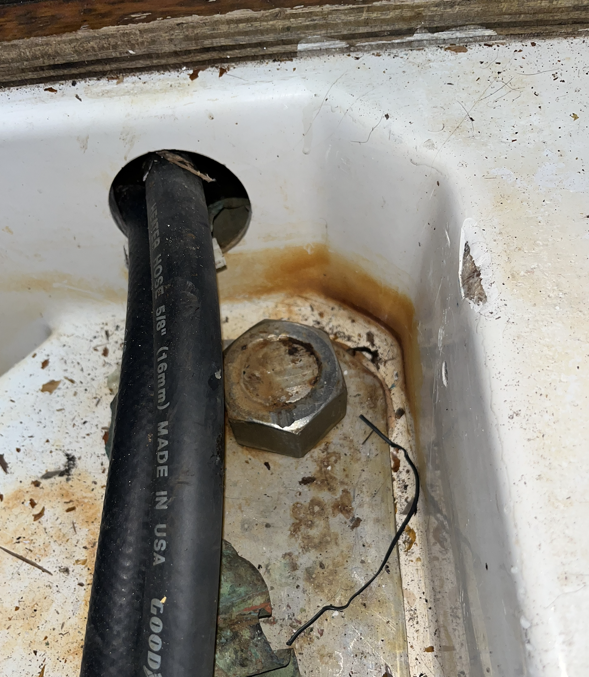

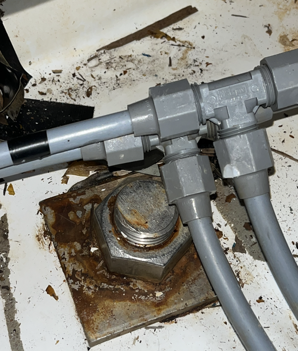

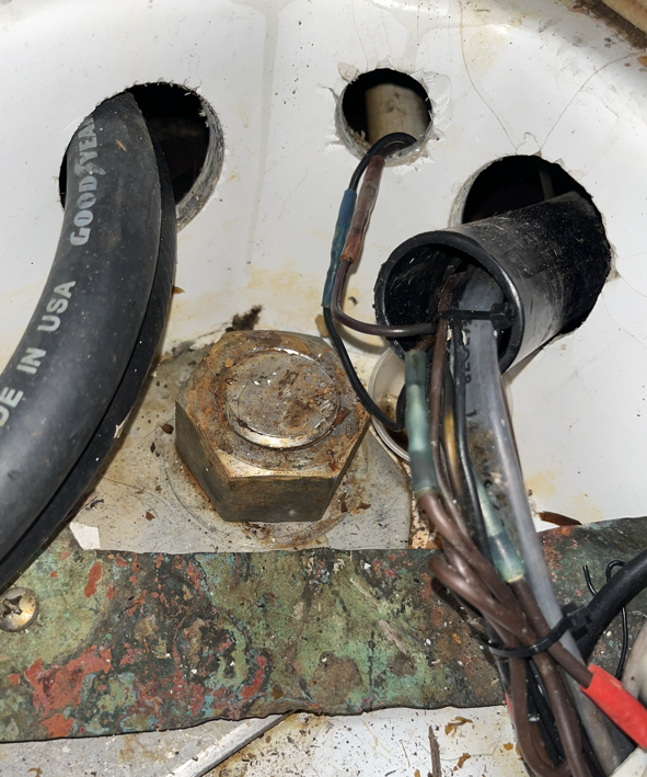

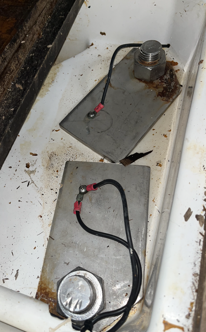

Thanks for the input, most helpful. Re your comments about the keelbolts - I'm attaching photos of the bolts from above (correction, I am trying to attach photos, and they aren't loading). As you can see, there is only some surface rust on them, from the standing water that was in the boat from being left to sit there. The bottom paint looks fresh, as if the work on the keel were finished, and the caulk in the seam looks tired due to age, but otherwise seems ok.
The joint doesn't appear compromised in any way, and there is no "cupping" or stress fracturing of the fibreglass at the back end of the keel that would indicate a hard grounding. Nor is there any indication from the inside.
I'm actually fairly confident that the keel bolts were replaced by the former owner, given what I can see, but I'd like to be sure before trusting my life to them.

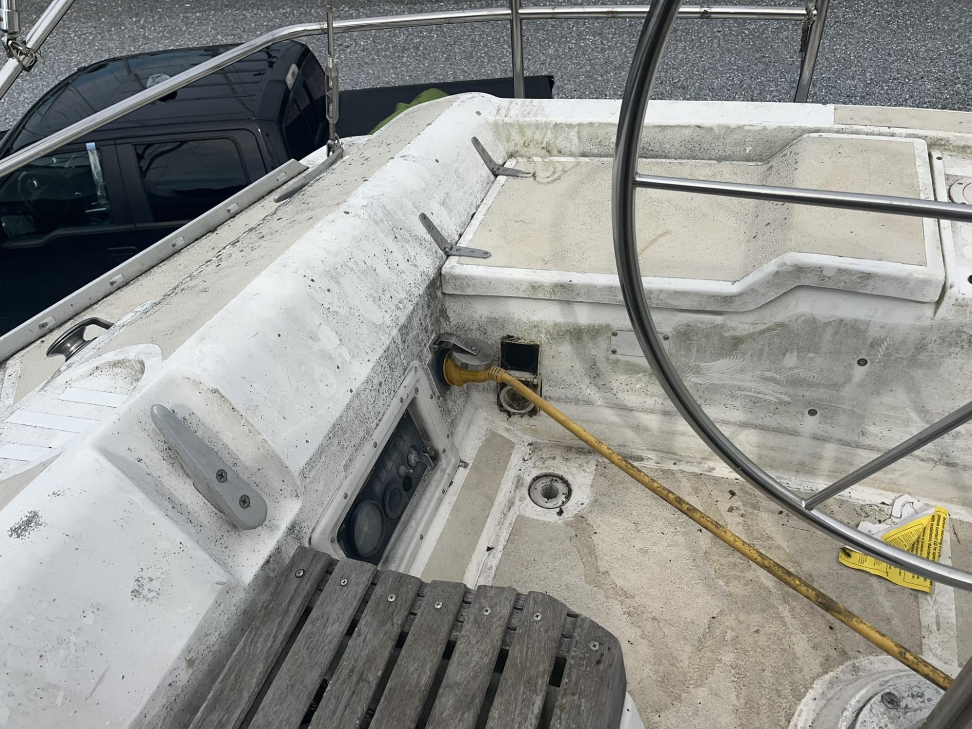

You're correct that there was water above the sole, but it didn't go all the way to the front of the boat, as can be seen from the cabin sole. The scuppers were plugged and the water leaked in through the control panel in the cockpit. The entire floor will be recovered since the teak and holly simply aren't recoverable, sorry to say.
I was thinking of drilling some pilot holes in the icebox to see just how much insulation is there. If inadequate, which is the norm, I plan to use spray foam insulation through those same holes, since access to the icebox is impossible without tearing out the cabinets. I may just use the spray foam anyway to be on the safe side.

I've seen a lot worst. I bet a stainless brush will take 95% of the scum and light surface corrosion away. If there's no smile when she's in the slings, I'd move on to other projects.
A few things that come to mind from the photos:
1) Bonding system of the keelbolts.... crimps are not sealed. Wire should be cut back and a heat-shrink ring terminal applied. Is this wiring tinned? If not, replace!
2) There's a black and brown wire going through a small hole in the fiberglass. The wires should be protected in split loom to avoid a short which could be caused by chafing.
3) Same with that presumably coolant hose? Another way of fixing this is putting split loom all along the edge of the opening (ie: make a donut with it!)
If you're pulling new wires: black and white are only for 120V AC! Use yellow for the negative for the DC systems.

The keel bolts look good - get some Spotless Stainless or Wichinox to treat the stainless steel, it will remove the rust and re-passivate the SS. I would still remove, clean and re-torque the keel nuts.
