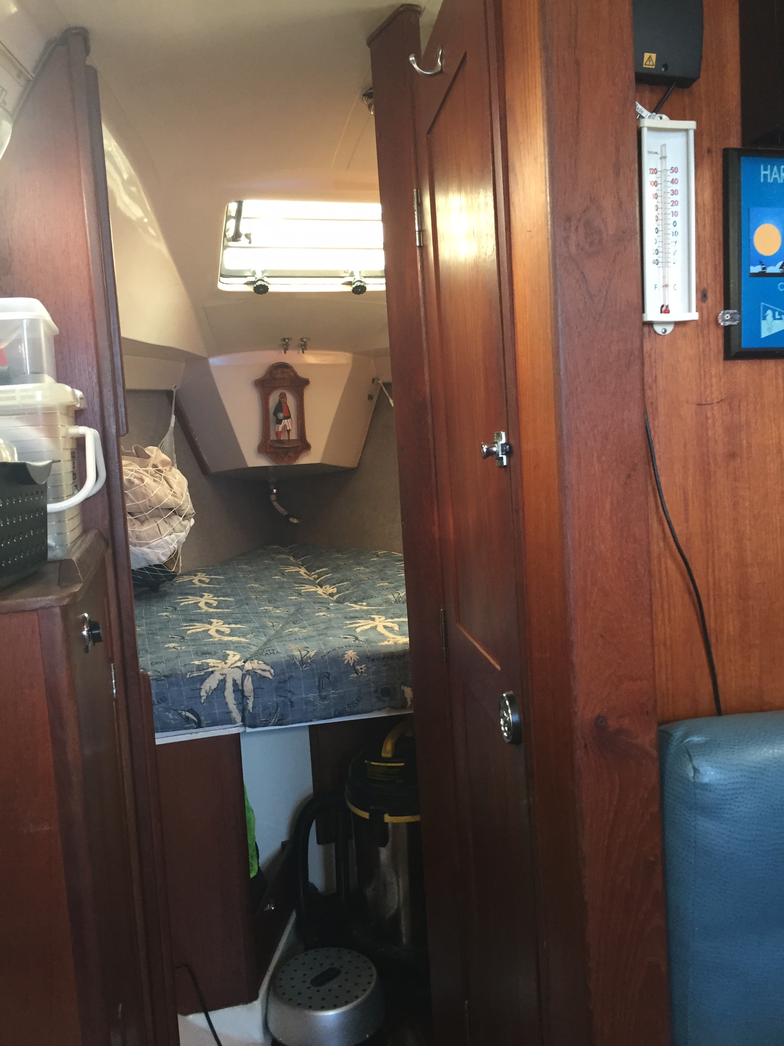

I redid the interior wood on my '83 H31. On mine the wood is either solid or a teak vaneer, either way it had been oiled likely with Daly's Sea Fin. I cleaned mine well with Murphys wood soap. Then tried a couple of experiments with Daly's and some other oils and I found the Formsby's High Gloss Tung Oil most closely matched what I had and brought the wood back to life. I did not sand, just cleaned then put many coats of the tung oil, it takes between five and seven to get a good shine. Wipe it on with a rag, use gloves, smooth it out and let it dry. If it's an oiled finish lemon oil will do amazing things. If your wood is varnished it's a whole other ball game. All of the wood in this picture was treated with tung oil and maintained with lemon oil.
