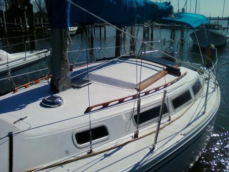

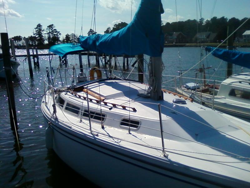

Finally sanded the heck out of the old teak trimwork and refinished it.
I used matt finish Cetol, but I'm thinking about going over this with another coat of gloss varnish. Anybody have suggestions on a durable varnish that doesn't cost 30 bucks a quart? I guess U get what u pay for but marine varnish is way overpriced. I wonder if anyone has tried regular spar type varnish not specifiaclly sold at W. Marine for twice the price. Still looks a lot better then grey & peeling finish that the boat came with.

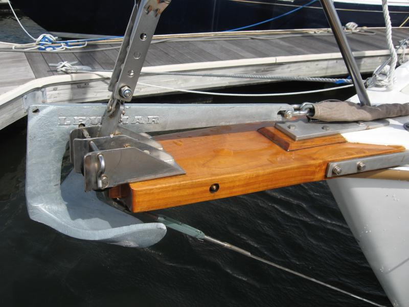

If you are already using Cetol why not just use Cetol Gloss over it? I used Cetol Natural and three coats of Cetol Gloss a few years back and have just did maintanence coats of gloss about once a year. The gloss doesn't have anything in it to change the color of the teak, just looks shiny. Here's my bow sprit for example.

Thanks for the responses everybody. Dan your bow sprit looks awesome. I just have the standard rig with no sprit. Was your wood ever replaced because I've seen some Catalina bowsprits that looked like they were ready to crack in half. Ron, didn't you say that this happened to your old sprit? As far as the finish, I have already applied the first coat of the lightly tinted Cetol, and I like the idea of following up with their gloss varnish. I assume that if they made it it will bond better to the existing Cetol. I'll post some pics after I lightly sand again & apply 3 more coats.

My bowsprit is original, I've never heard of one breaking but Ron has heard of several, or, maybe he's even had his own fail, I can't recall? I believe Ron is on the west coast though, and there may be something to anchoring in a swell out there that we just don't have where my boat is (it was delivered new to a lake in Texas and has spend much of it's life in pretty easy conditions on Galveston Bay). I do think that I read somewhere that Catalina says you aren't supposed to anchor with the bow roller on the sprit but I've always figured that is just the lawyers talkin'! ;-) I've anchored out for probably a couple of hundred nights and.. well... my bowsprit looks just fine.
