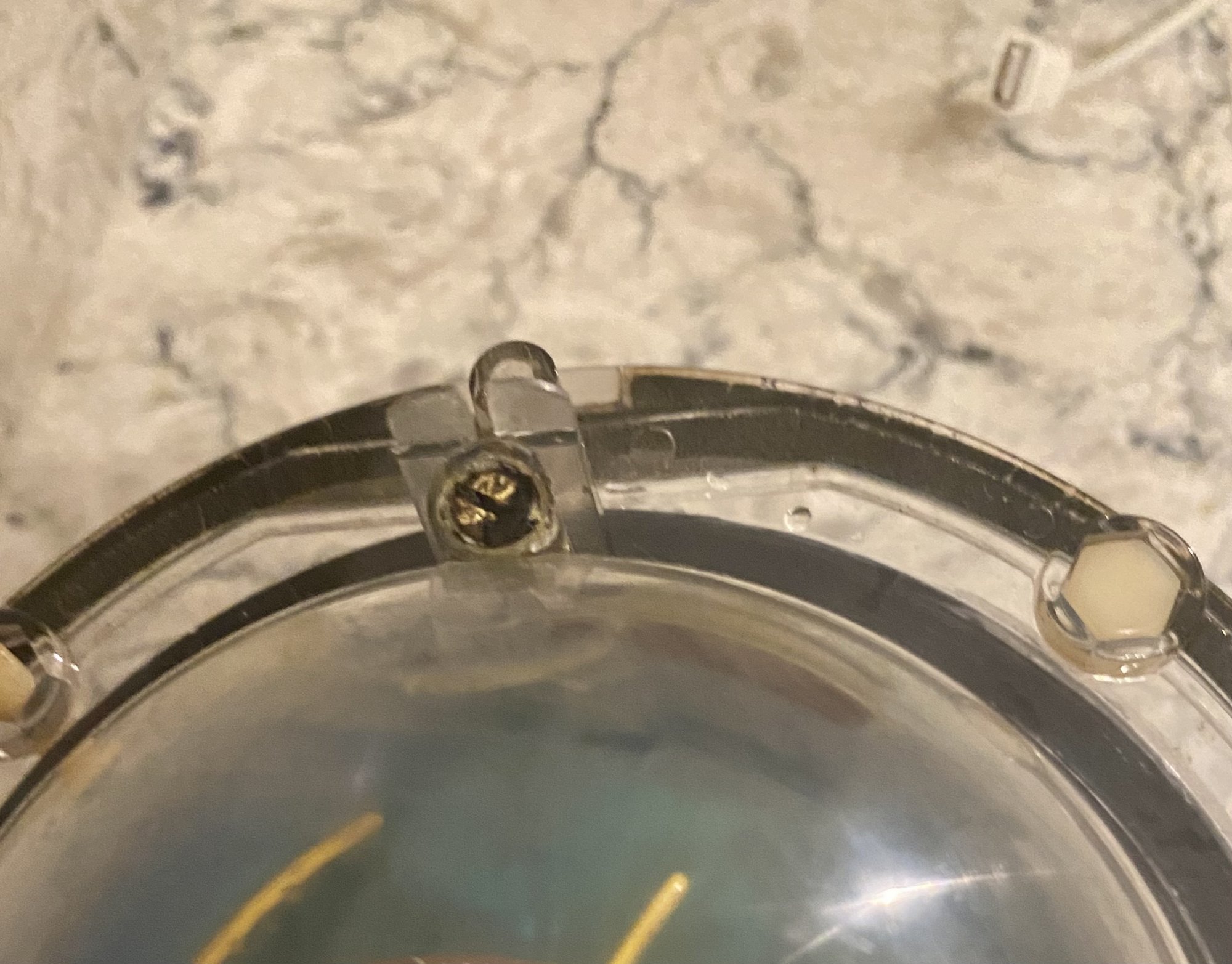

Hi all. I’m trying to salvage our old Plastimo Contest 101 compass which has lost half its fluid. I found lots of discussion and the fact that there is a brass screw you need to remove to add fluid but I can’t find it anywhere on the globe. Can anyone help me out? Thanks!

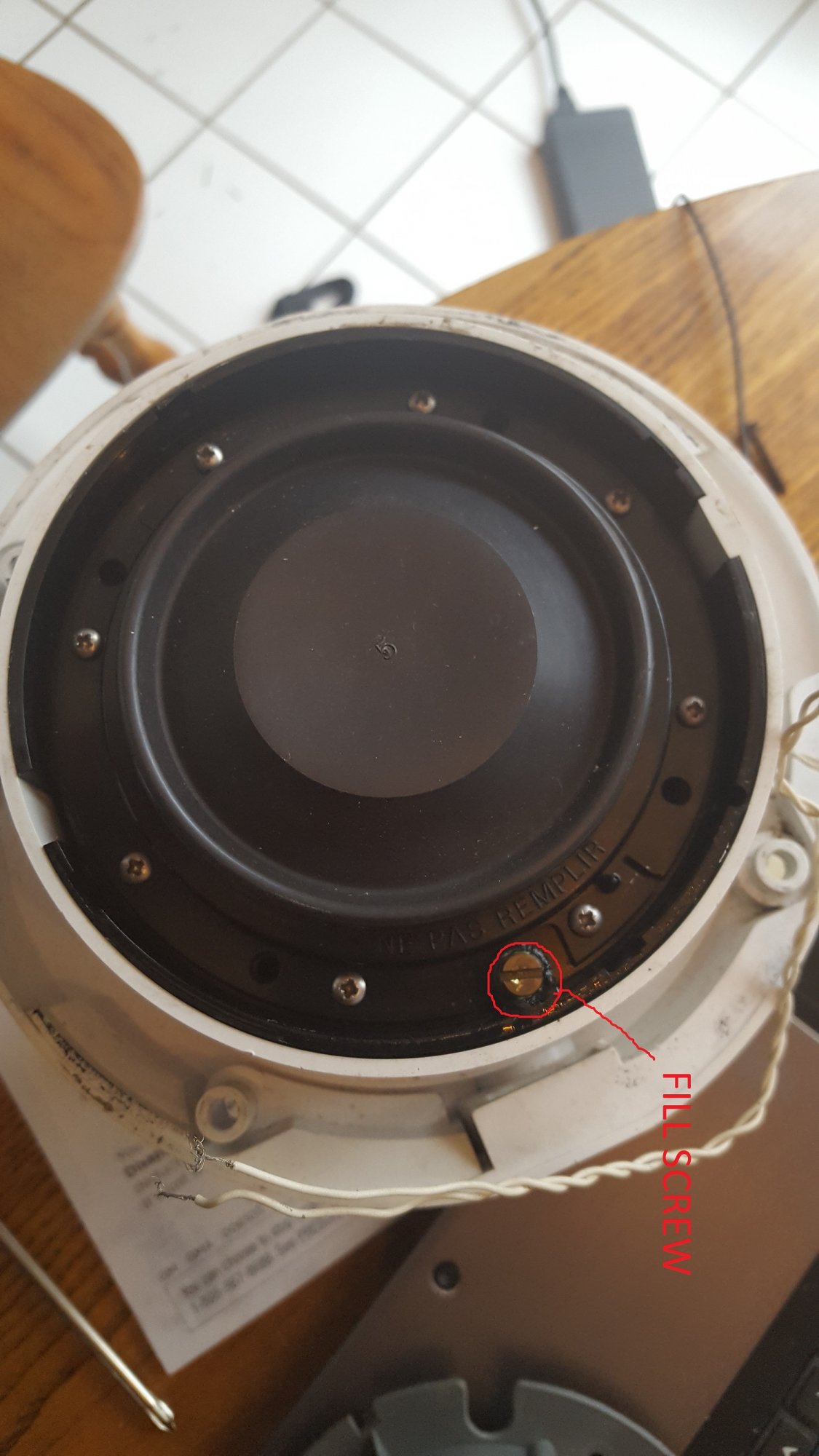

I worked on a different compass, so keep that in-mind. I found the fill port on the bottom of the unit toward the edge.

Thanks for the help all. Turns out it was right in front of my face, just under a black paint or caulk seal. I just need a temporary solution for now so I’m going to give refilling it a shot
