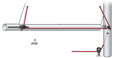

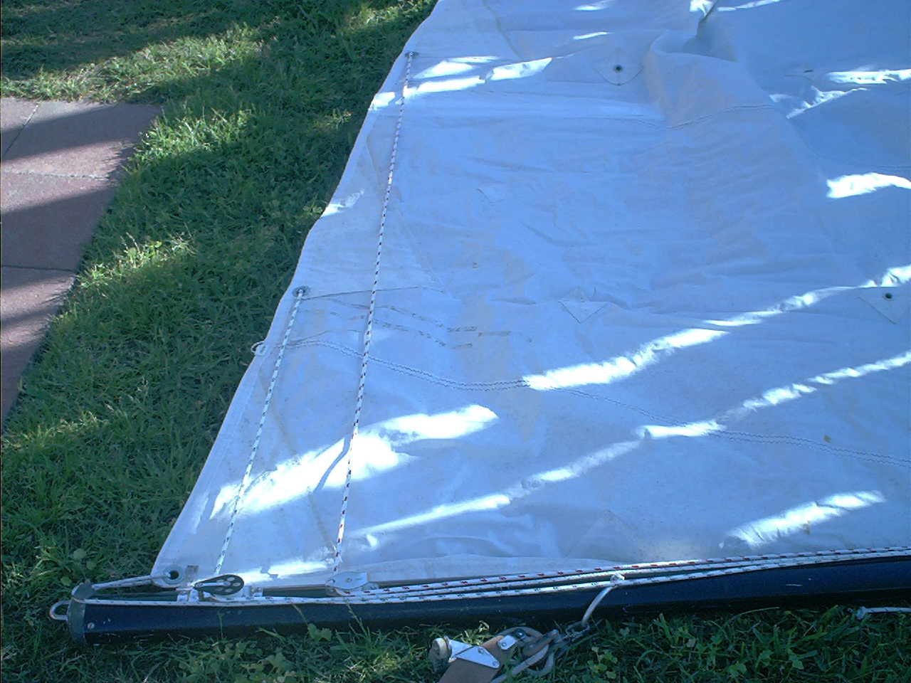

I first tried single line reefing and found that it had way too much friction to be useful. From there it only takes one more block and one cleat to convert it to double line reefing. In my opinion it's a much better system giving you control of both the tack and clue separately.
