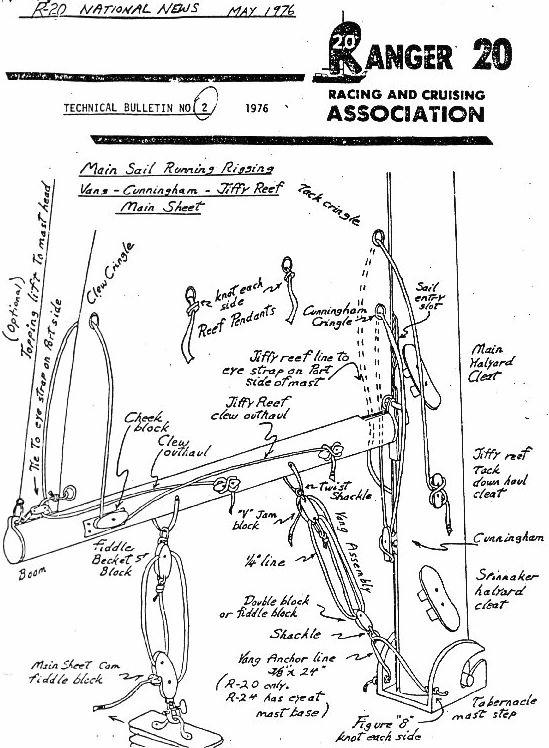

I've got a couple of diagrams you might like. Hope they help!

Start the motor to tack into the wind, ease the halyard. One of the setups shown by justsomeguy needs to already be in place, then pull sail onto boom and tie in place. Re-tighten the halyard
