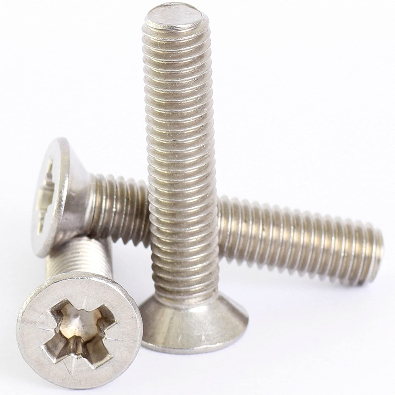

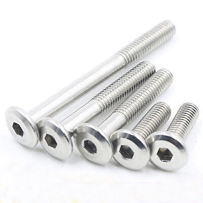

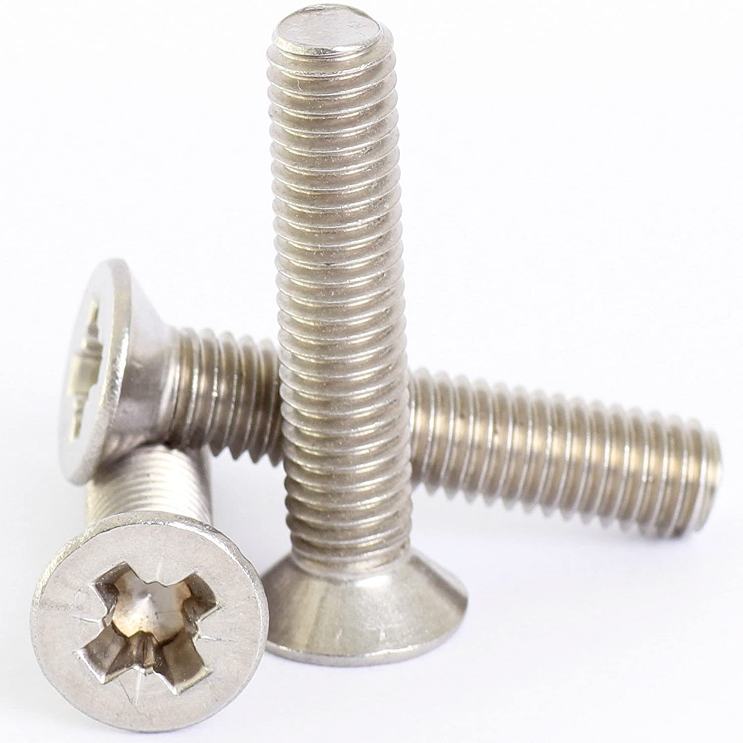

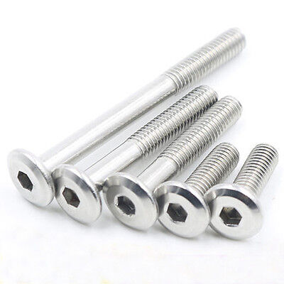

I rebuilt my deck turning blocks using SS capsrews. If you have enough room inside your blocks you can use 6mm or so ss countersunk screws. You want the type where the tread doe not go all the way to the head.
Not like this. As the tread will chew up the inner of your new sheave.
You want something like these.
Then and acorn nut or nylex nut on the outside.
