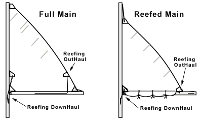

Generally, the aft-most grommet is the clew cringle and the fore-most is the tack cringle. These are generally designed to take the strain of tensioned lines when reefed. The other ones that run along the sail - these are not intended to be load bearing, and are often referred to as reef points.

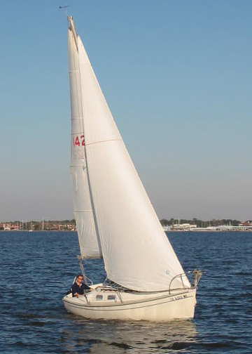

If you want a definitive answer it is best to show a photo of your main sail raised up on the mast.
Here is a picture of a Chryseler 22. You can see that this mainsail does not have reefing points.
A @Foswick explains the cringle on the luff and the cringle on the leach are there to create a new tack (shortening the sail to the first reef) and new Clew.
If your sail design has these two reef cringle (note these will be reinforced to handle the strain) then you have a single reef. The points in between these two points are used to bundle the middle of the sail. They have no strength and should not be tied to the boom.

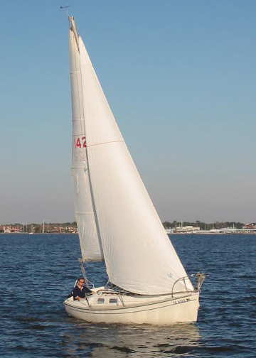

I think this is what I have. We are planning on taking the boat out next weekend (weather permitting). I will be taking several photos and making some posts then.
