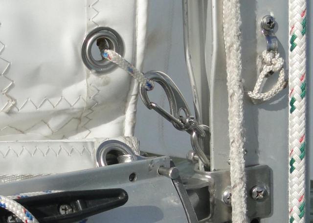

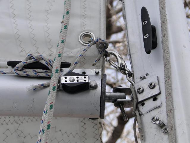

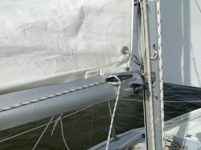

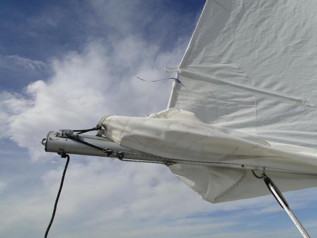

Ive been single handing this spring with this system - working fairly good.
If I need to reef, Ill put the boat in hove to (boat needs to be moving slow just before you "lock it up"). Once in hove to, I go up to just in front of the mast and release the main halyard and the boom kicker keeps the end of the boom from dropping.
I "hook" the forward reefing point on the main (see the picture) and have a single reefing line to pull in the main sail rear reefing point and then cleat the single reefing line - cleat is on the boom near the mast.
Tighten the main halyard and its ready to go. This is my fastest sail config (reefed main, working jib) and I can get the reefed main nice and tight - looks like I still didn't do as good of job as in Mr.Bill's picture.
Sail has only one reef - keeps the setup simple - and I don't have to mess with the slugs at all even during reefing.
