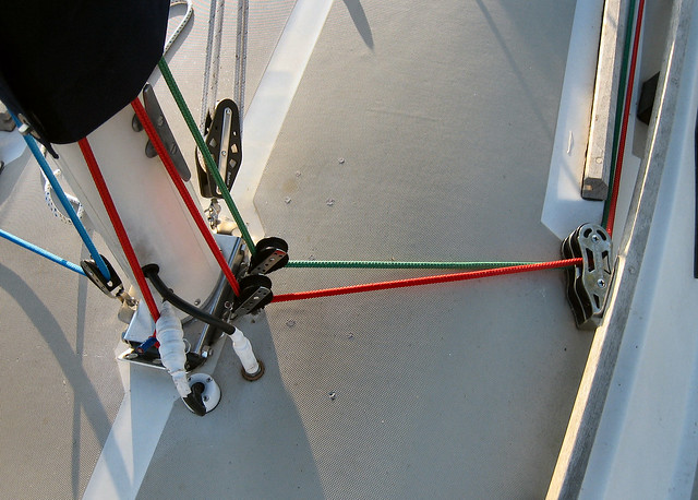

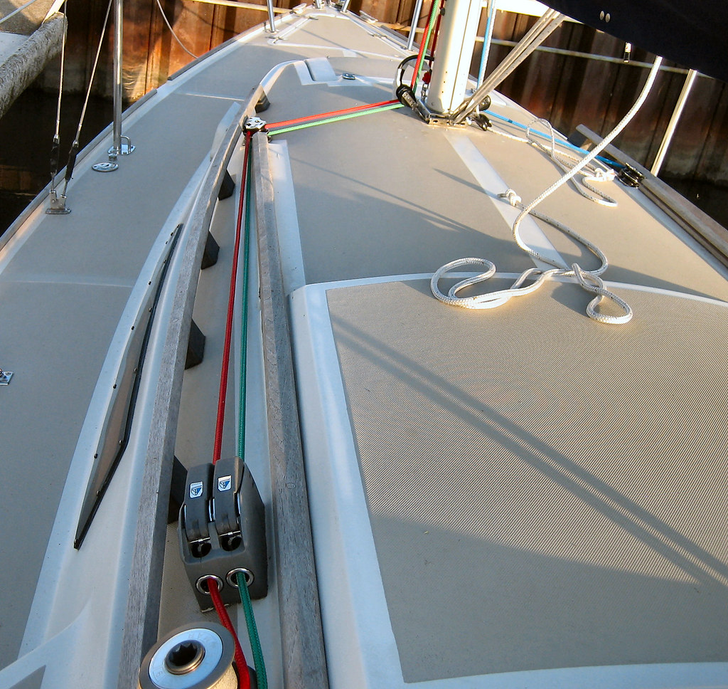

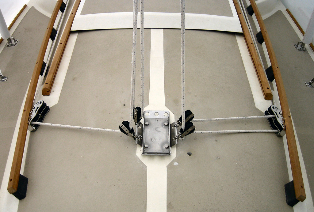

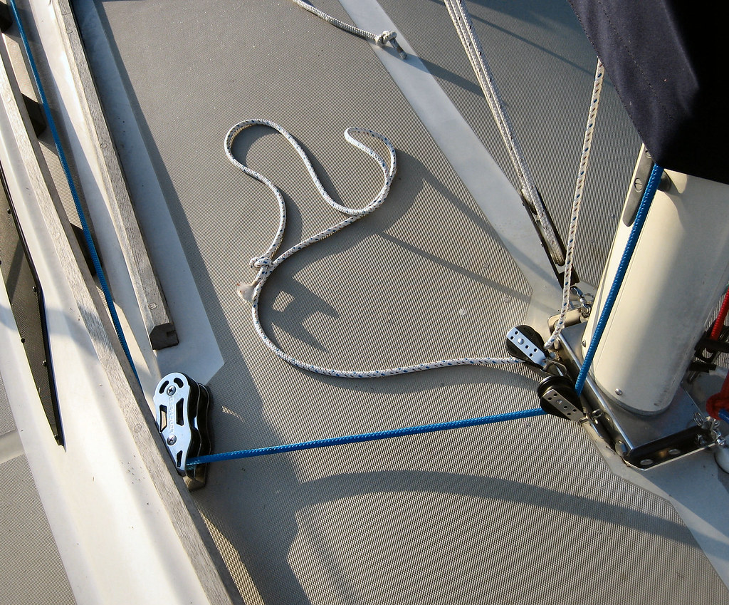

Rich,
That looks awesome! Nice and clean, and exactly what I was hoping to find.
Can you tell me what color lines go to what?
Did you mount the winch near the locks or is that a standard location on the 1984 model of the 25?
Paul
Sep 25, 2008
992
Oday 25 Gibraltar
No, that's not the standard location for the winches. Oday didn't make any provision for cockpit controls (that's why there's so little room at the forward end of the companionway slide) on these boats which was a holdover from the 70s when they were designed. Cockpit controls really came on big in the eighties.
I didn't have any winch halyards which were an option and were mounted on the mast.
Blue- main halyard
Green- jib halyard
Red- spinnaker halyard
I want to run the cunningham along side of the main halyard and maybe the spinnaker tack pendant.
Rich
