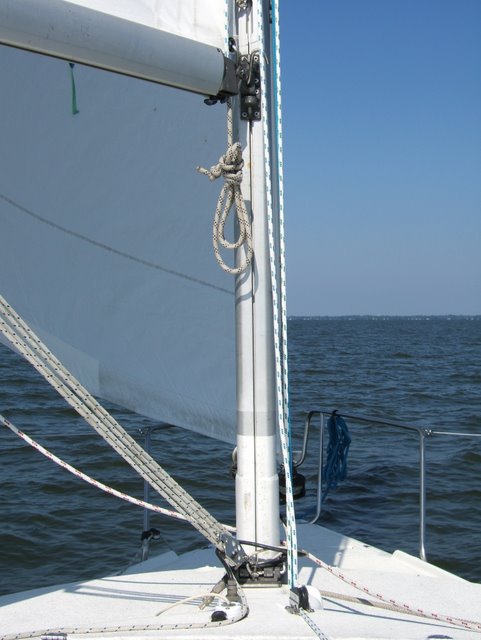

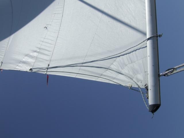

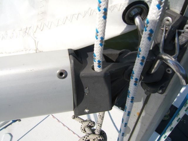

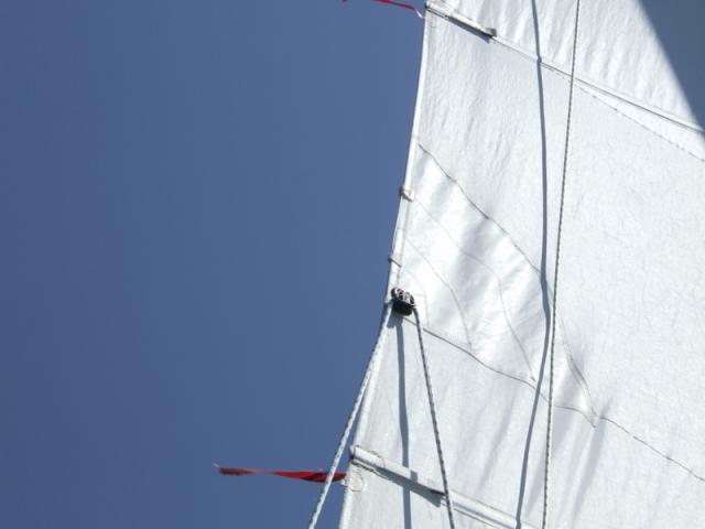

I completely reworked the reefing line into a single line and do not use the ramshead hooks. I added blocks to both reefing eylets because the line will not run smoothly or easily through them. I drilled a hole in the top of the boom near the goosneck and reversed the direction of the reefing line to go up not down. So.. the line attaches at the boom with a simple knot, goes up to the reefing block at the rear of the sail (leach), returns to the boom as normal and through the boom to the mast but goes up to the reefing block at the front of the sail (luff), back down to the cabin top at the mast base, then is led back to the cockpit and a cleat. Because I do not use the hook at the mast I can do it all from the cockpit. If it is really nasty, as in I waited too long to reef then I do not go up and tie the small llines that gather the sail in tightly, and if I do go up on the cabin top those lines have hooks on them so I can gather the sail and hook quickly not taking a long time to tie a knot.

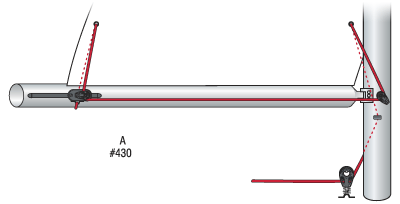

Ah yes, the single line reef mod sorta like this Harkin diagram, except utilizing the internal boom blocks. Two small blocks on the sail are certainly needed on the 260/26. I also did this simple mod and it's a nice perk. Great pics to tell the tale.
