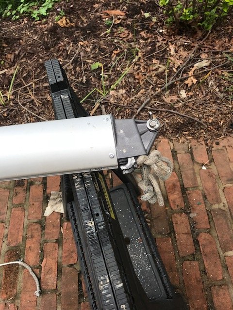

I wish I knew, It takes some effort to remove, so there had to be a reason. With a back and slight motility issue I am trying to bring everything back to the cockpit. All the turns greatly increases the effort to involved, so I was concerned that the original set-up proved too difficult. I can run it outside of the boom possibly with slightly larger line and shives cutting the friction some...just not as fancy. That is why I asked the forum how they felt about the original system. I just connected the outhaul by looping it thru a large pad eye that had been placed at the end, underside of the boom.

It doesn't work, just keeps the sail attached, It just attaches the sail to the end of the boom. I need to fix the whole mess, I can find replacement parts (amazingly for a 27 yr old boat), I just want to know if the original reefing system works well on a '92 Hunter 30T, or should I put together something else.
