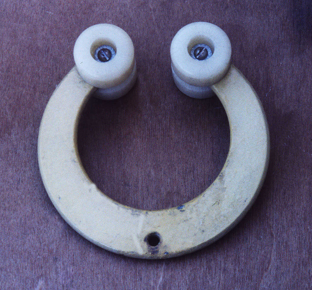

And a picture of the reefing claw, might be possible to make one as they are pretty rare these days and not cheap.

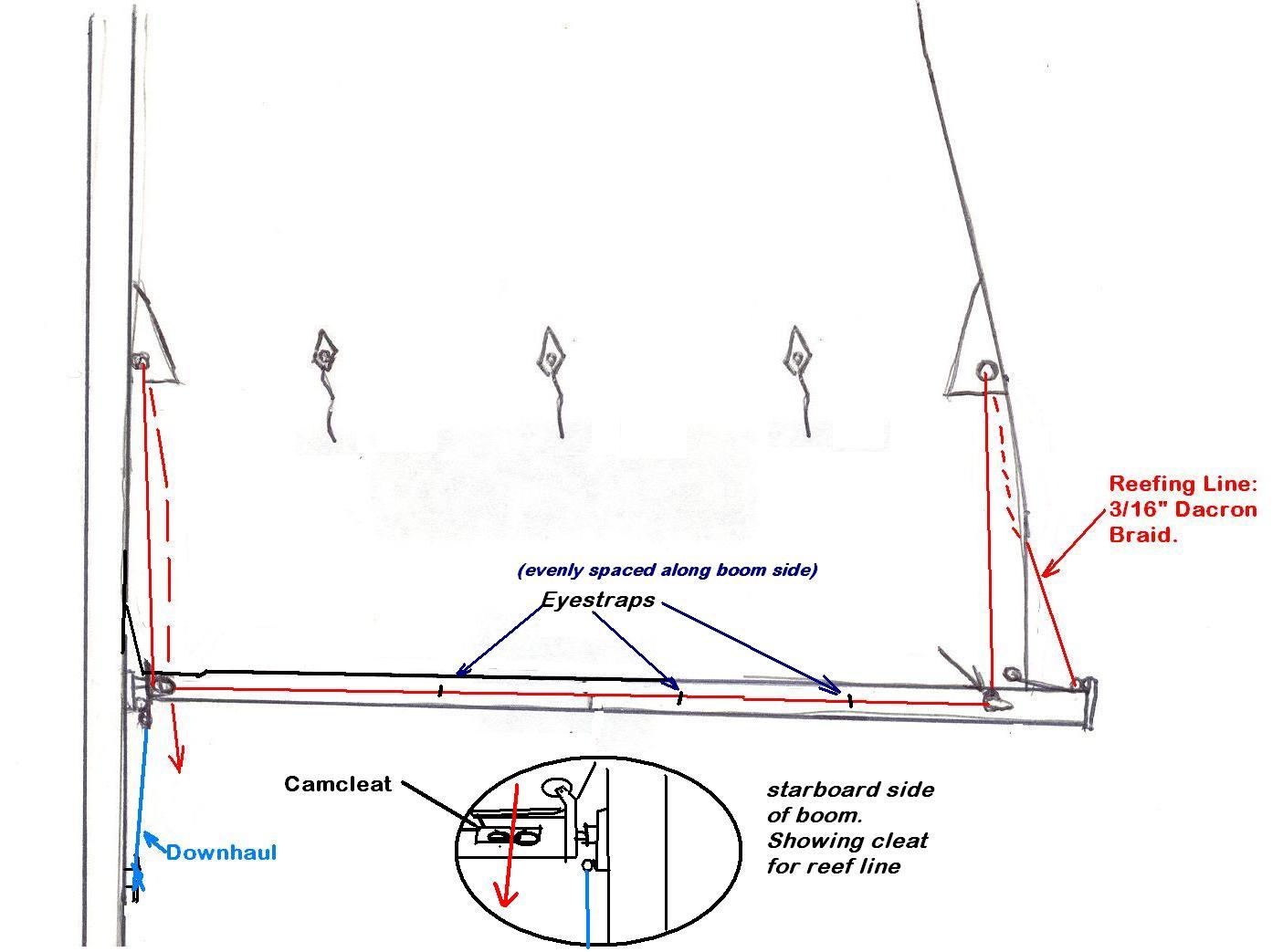

Oh here is what I have now: JIFFY-REEFING SETUP ON “SUNBIRD”
1979 O’DAY DAY SAILER II (As added by owner (Rod Johnson)
A have added a “Block-Action Outhaul” similar to the O’DAY option and use the shackle that attaches the outhaul to the clew of the sail as the starting point of my reef-line.
The reefing line (3/16” Dacron Double-Braid) needs to be dead-ended on the boom, aft of the sail clew, either using an eye strap on the starboard side of the boom or underside of the boom (unless rigging as I did). Line then runs up through the reef cringle in the leech of the sail, then down to a cheek block on the port-side of the boom (aft of the sail clew when reefed), then forward along that side of the boom (I placed 3 eye straps along the side of the boom to run the line through to keep it from hanging loose) to another cheek block near the gooseneck end of the boom, then up through the reef cringle in the luff of the sail, and down to a cleat on the starboard-side of the boom near the gooseneck. I use a cam cleat, but a horned cleat could be used instead.
To Reef:First, release the main halyard until the reefing tack cringle, has reached the boom. Second, pull reefing line to bring the clew cringle down to the boom and to also pull it aft to tension the foot of the reefed sail. Once the reefing line is tight enough, secure to cleat forward on starboard side of boom. Fourth, tighten halyard. Fifth, wrap the 3 short lines that run through the reef points around boom and tie off (use a “reef-knot” or slip-square-knot to allow easy and quick release when shaking out the reef, aka: un-reefing the sail). These lines are 3/16" braid, 2' in length and are run through the reef points (small. holes in sails) tie a knot in the middle of each line on each side of the holes, let them hang down until ready for reefing. I keep these reef point lines rigged all the time.
There are other ways to set up this style of reefing, larger boats sometimes use a reefing hook attached to the gooseneck to secure the tack cringle, and rig a reefing line only for the clew cringle. That was how we rigged our old CAL 21.
