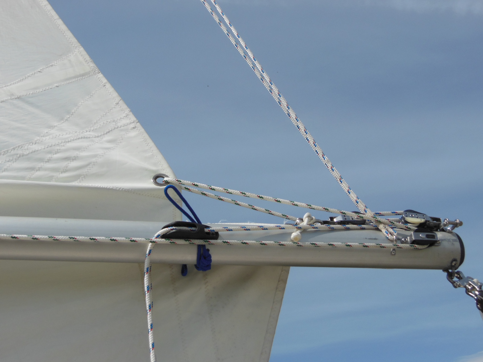

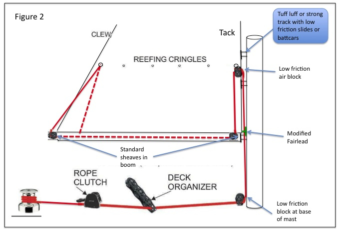

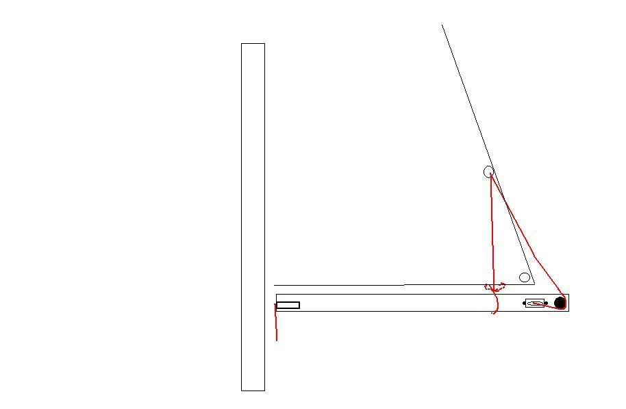

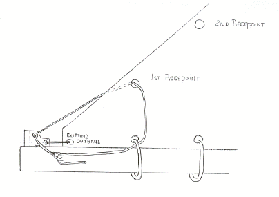

There are a multitude of ways. Doesn't really matter what the boat is. Here are a few.....
