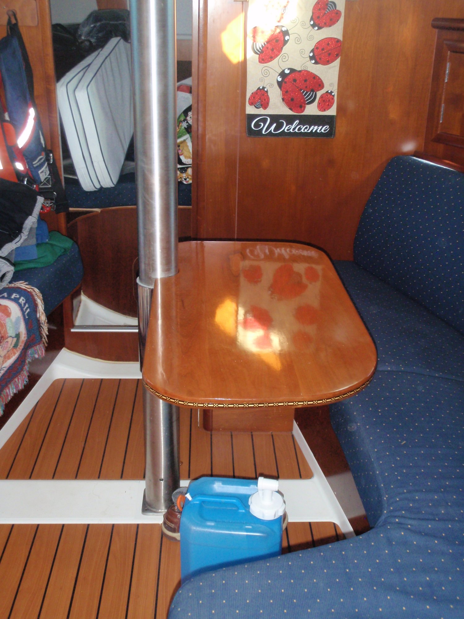

I found that table way too big. I have a B331. See the picture attached. I made it from American Cherry, and banded the edge.
Please excuse my messy boat.
I note the European version of my boat has a folding table, which would be better. With the original one, you had to move sideways to get to the v-berth.

Very nice. How is it attached?
Jan 10, 2018
264
Beneteau 331 Halifax
Same way the other is attached. There are flat steel bars under the table that it (and the original one) screws to from underneath. You have to cut the wood so that it at least covers the bars.

Got it. Thanks. Mine is built up from the floor and is a lot bigger (like the one pictured above). I would like to convert it to something less obtrusive.
