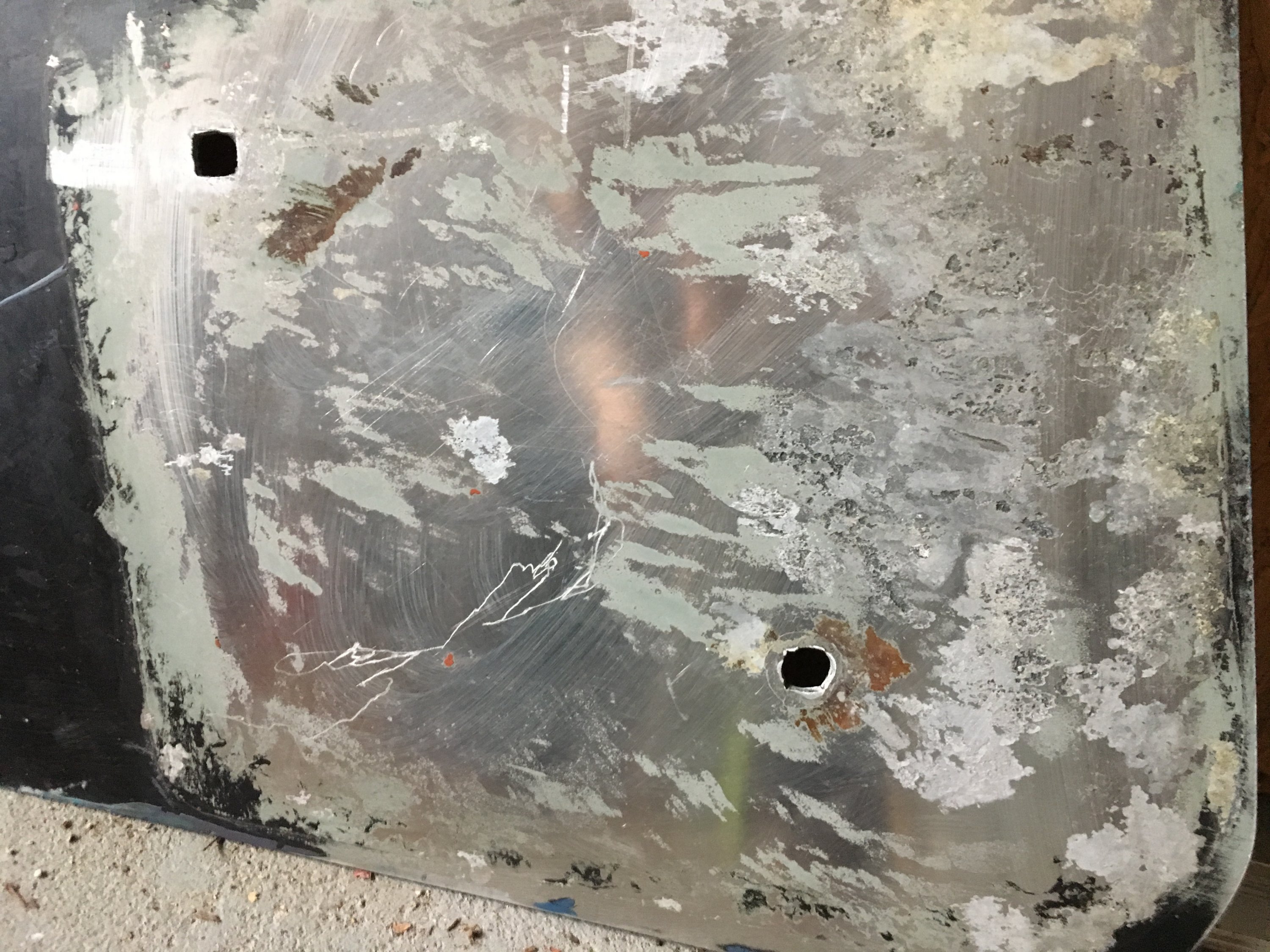

I'm in the process of rebuilding my H 23.5 rudder assembly. I was told to use the 3M 90 spray adhesive as well. When i used acetone to remove the old glue residue it also removed some of the black (?antifouling?) paint. Does anyone have any advice on this? I was going to recoat it with interlude 33 outdrive antifouling black paint but is suggest that a primer would be needed. Anyone know about this? And secondly do you sand down the rudder plate prior to spraying on the adhesive and if so with what type/grit? See pictures below for current status. (I still have a few spots to put some elbow grease into but its mostly prepped
Thanks!!

Doc,
Yes prime it first. Then topcoat and let it dry thoroughly. Lightly scuff sand the topcoat only where you'll spray the glue. Don't sand through the paint. Don't be stingy with the adhesive and follow the directions on the can. Good luck.

dennis...thanks! do you think i need to paint under where the red rubber will be or just the exposed areas. also any suggestions on primer and grit for sanding prep for glue? oh...and do i need to sand the metal before primer coat? thanks for guiding this novice!
10,531
-na -NA Anywhere USA
Paint the whole thing. Dennis would concur. Ask Dennis Kitchen which adhesive he would use as he has done it and it was 2010 when I retired. Thanks Dennis for helping out sir as I appreciate your assistance here.
