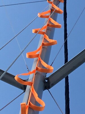

Anyone have any experience with this particular mast step ladder? I need to get up my mast soon and fix steaming and anchor light so i can pass a required Coast Guard Inspection.
I have used the fixed rung style ladders before that you haul up with the main halyard. Problem with this style is they dont secure to the mast anywhere else so tend to swing around a lot when trying to climb them. The Recovery Marine style ladder attaches to the sail slugs in the track so to me looks like it would be a lot more stable and safer to climb.
Eventually I want to add bolt on folding mast steps, but they are out of the budget for the moment. The good ones would cost almost $2k. The ladders are only $300ish so seem like a good compromise for a quick solution but was hoping to get a little feedback from any users of this particular ladder or a similar one that attaches to the sail track.

I used a Mast Mate--which seems to be a similar product that goes up the sail track--ladder on my previous boat and was very happy with it. I used it to rig up a new forestay, replace the anchor light, and do inspections. It felt very secure, especially with their optional tool belt that went around the mast to help keep you from falling backwards. I miss having the option to easily go up the mast, but my current boat has roller furling and no track for slugs.

I have also used a mastmate. Fairly easy to climb, but also use a safety harness. A little hard on the feet and be careful getting feet in and out of the loops.
You will be standing the whole time, so that can be tiring, and you need some sort of strap so you can let go of the mast to use your hands to do the work.

  • Always roll the ladder for storage so that the loops pop open.
  • Tension HARD so that it does not move.
  • Use shoes with no tread and smooth soles. Easier in an out and still very secure. NO TREAD.
  • Rubber-faced gloves for grip on the mast and stays.
  • Better than an ascender is a device like a Camp Goblin or Petzl ASAP. These are actually rated for for fall arrest (ascenders are not) and they track up and down the rope without attention. I've used these climbing masts, work at height, and countless rock climbs and falls. MUCH better and safer than an ascender for solo climbing.
  • A seat is bulky and slow, but adding wider padding to the legs of a climbing harness is smart. Stiff foam work-out room tiles work well.

I have a mast mate and I am short and not as flexible as I once was. The one and only time I used it i found it very difficult to reach the 17" steps. If your shoe catches the edge or it didn't fold down completely it can be frustrating. They do make a short person version with 14" steps but it is much more expensive. I did follow @thinwater's guidelines, but I think a few more tricks might have improved the experience, at a minimum take a short stick so you can reach down and move a step without having to backdown, fix it, and try again.
One thing that did work well was that I used a bosun's chair with my safety harness. This let me comfortably rest from time to time by hanging in the chair.
