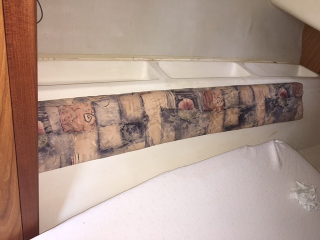

My wife is updating our 380 with new curtains and she really wants to reupholster the headboard. I can't figure out how to get it off the wall section. I thought that when i removed the teak trim along the top I would be able to pull the whole assembly. Unfortunately, the wall liner is glued to the top couple inches. If anybody knows the secret I would appreciate some direction.

I just had the aft cushions of my 380 remade and the headboard recovered. My headboard just pulled right off. There are plastic "christmas trees" attached to the backboard. My upholstery guy made an entirely new headboard. He used plastic star board for the base of the unit. New foam and new cover.

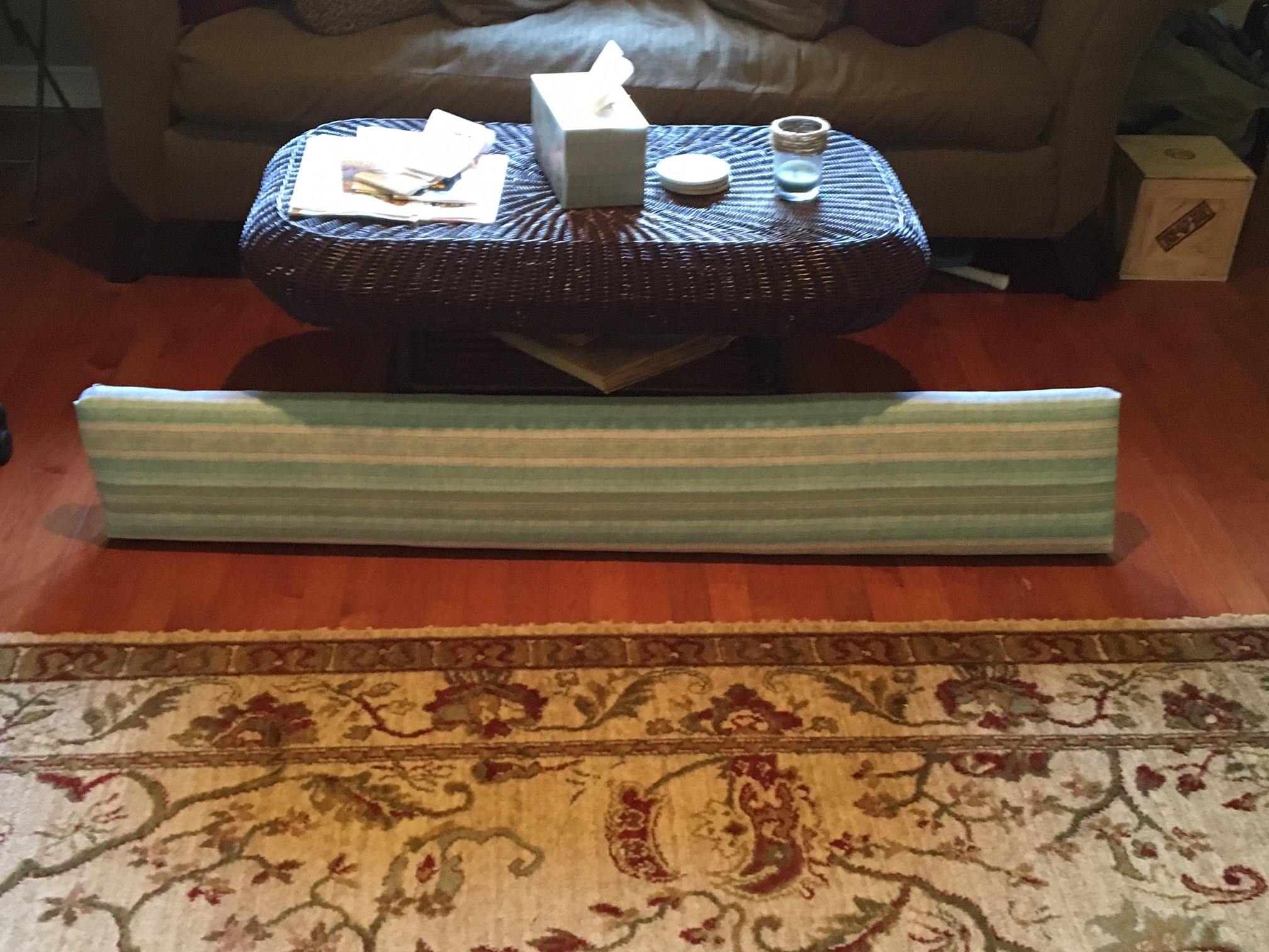

Well you were absolutely right,,,4 or 5 good yanks and had it in hand. Carrie has made curtains to match the headboard too.
