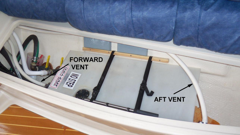

The holding tank contents are "properly treated" by the unspoken, the vent lines, which supply air (which is about 21% O2) to promote aeorobic decomposition. There are other means (chemical) of getting O2 into the contents but this is the simplest and cheapest. Cheap is the reason I choose to use vents rather tham chemicals. And speaking of cheap, I always take my eyeglasses off when I'm not looking at anything so as not to wear them out.
And as you say, because CO2 requires a little motivation to keep moving along, dual vent lines are better than just a single vent line :
The forward vent hose is connected to an above the waterline thru-hull at the beam of the boat and the aft vent hose exits at the aft end of the hull which sees slightly negative air pressure while under way.

Dual vent lines are NOT the best way to increase air exchange in the tank and chemicals aren't an alternative...a few are just able to work with less air exchange. A single vent will work just fine IF:
a) it's short (no longer than 5-7', straight and doesn't rise more sharply than 45 degrees.
b) the "vent" thru-hull is replaced with an open bulkhead (aka "mushroom") fitting that will let the tank "breathe"..."vent" thru-hulls do not.
Aeration is a much better choice than a second vent and doesn't have to be expensive...many boat owners are DYI-ing aerators using a bait tank pump and a perforated (poke holes in the top of it) piece of hose run across the tank near the bottom of it. To work, aerators MUST run 24-7-365 whether you're on the boat or not, but the current draw is very low. When not running the tank will quickly turn anaerobic, forcing stinky gasses out the vent when it's turned back on that can take several hours to slowly improve.
