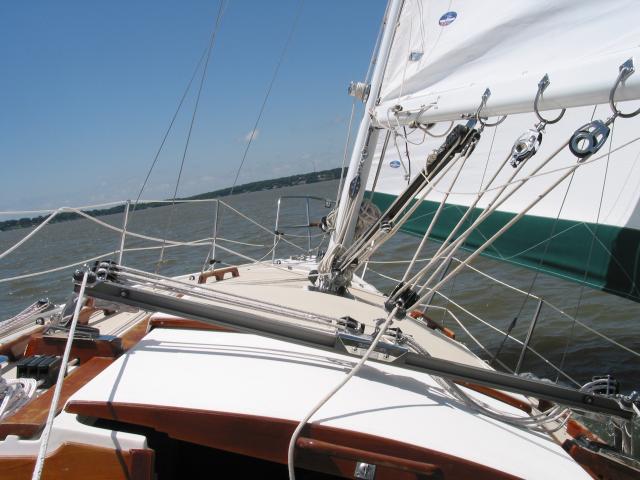

Yes, I'd go with 5/16. I just added Garhauer Traveler, Mainsheet, Rigid Boom Vang and EZ Glide Genoa turning block system. I learned if you want the systems to glide easily, it's best to use as small a line as is practical. Large lines add considerable drag and put the brakes on multi-block systems. You need to compromise between comfort to the hands and a good running system.
23,360
Good, Bob, 'cuz U did the right thing. I went up to 3/8th and found that over time the line swelled, blocking the, ahem, blocks. The smaller line is fine with the monstrous purchase that the traveler blocks provide.

I sewed new line to the end of old using dental floss. Waxed sail thread would also work good. I did this to replace the internal halyards. You're right, pictures work great for the mainsheet etc.
A trick I used on the mainsheet is to use a triple block with a cam cleat that Garhauer made for me. In light air I use the cam cleat and can let the go easily. In heavy wind you can still use the winch on top the starboard cabin top at the other end of the sheet.
