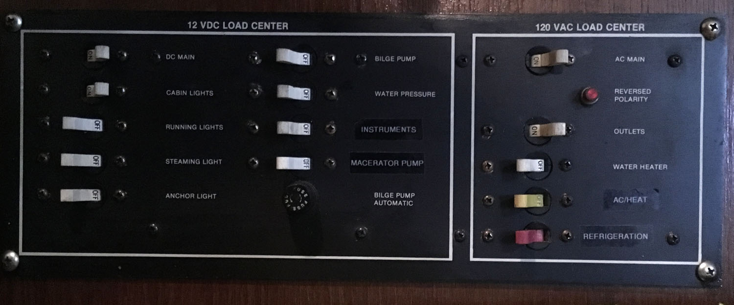

The pump moves water out of the bilge but doesn't shut off. There's a Bilge Pump switch on the main control panel and that's all I know of.

Like Ken Cross indicated, there is a (2) position switch, hold to the right is manual when you release that is springs back to automatic, if the pump continues to run with the switch in the auto position then the float switch needs attention.

when I move the switch to the right "ON", the pump comes on. If I release the switch, it stays in the "ON" position and the pump runs until I shut it off.

Your panel orientation would indicate to me that the top bilge switch is the manual operation switch, with that switch in the "off" position the bilge works off the float switch.... "Automatically". The boat being new to you, you could always put a bucket full of water in the bilge with the top switch in the "off" position and check to make sure the pump runs automatically.

Okay... I see what you're talking about. Yeah, if I don't push the switch all the way to the right to where it clicks, it only runs as long as I hold it. Must be a float problem then because I filled the bilge to the top the other day to flush it out and the pump didn't come on until I turned it on.

Here is a link to the owner's manual: http://sbo.sailboatowners.com/downloads/Hunter_31_83-87_64283881.pdf
That switch is the manual switch. The pump will stay on until you turn it off. When it is "off" the pump is then on automatic, controlled by the float switch circuit. That circuit and its wires and connections, including the float switch, are notorious for corroding to where power cannot get to the pump.. First check all the connections going to the float and pump.. then check the float itself.. If water got into the wiring, you may have to pull new wires in and put in proper waterproof connections.. Good luck with it, dude..

Quick note, to de-power the float side of the system to work on it, you have to remove the fuse marked "bilge pump automatic". This is fed from an "always hot" wire from the big main battery switch (off, 1, Both, 2) .. That bilge pump circuit is powered even when the main switch is "off" and the panel master switch is "off".
