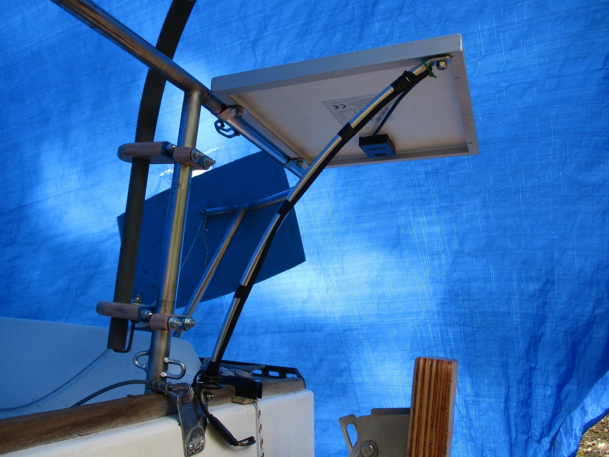

On our Mac 25 we have a 30W solar panel which maintains a single 12v group 24 marine battery. besides a few led lights, we use a small Garmin chart plotter, cd player/radio, and usb charging ports etc. been using that for 4-5 years and it works quite well for multi day trips with no other charging available or needed.
On our Merit 22 we have a 20W system charging a small garden tractor battery and the loads include a couple led lights, a small Garmin, an electric keel winch (only used once per day) and usb charging ports. that system has also been quite satisfactory. both systems are mounted similar, to the stern rail where they are out of the way and maintenance free. This is the one on the Merit (which was under a blue tarp at the time of the pic):
