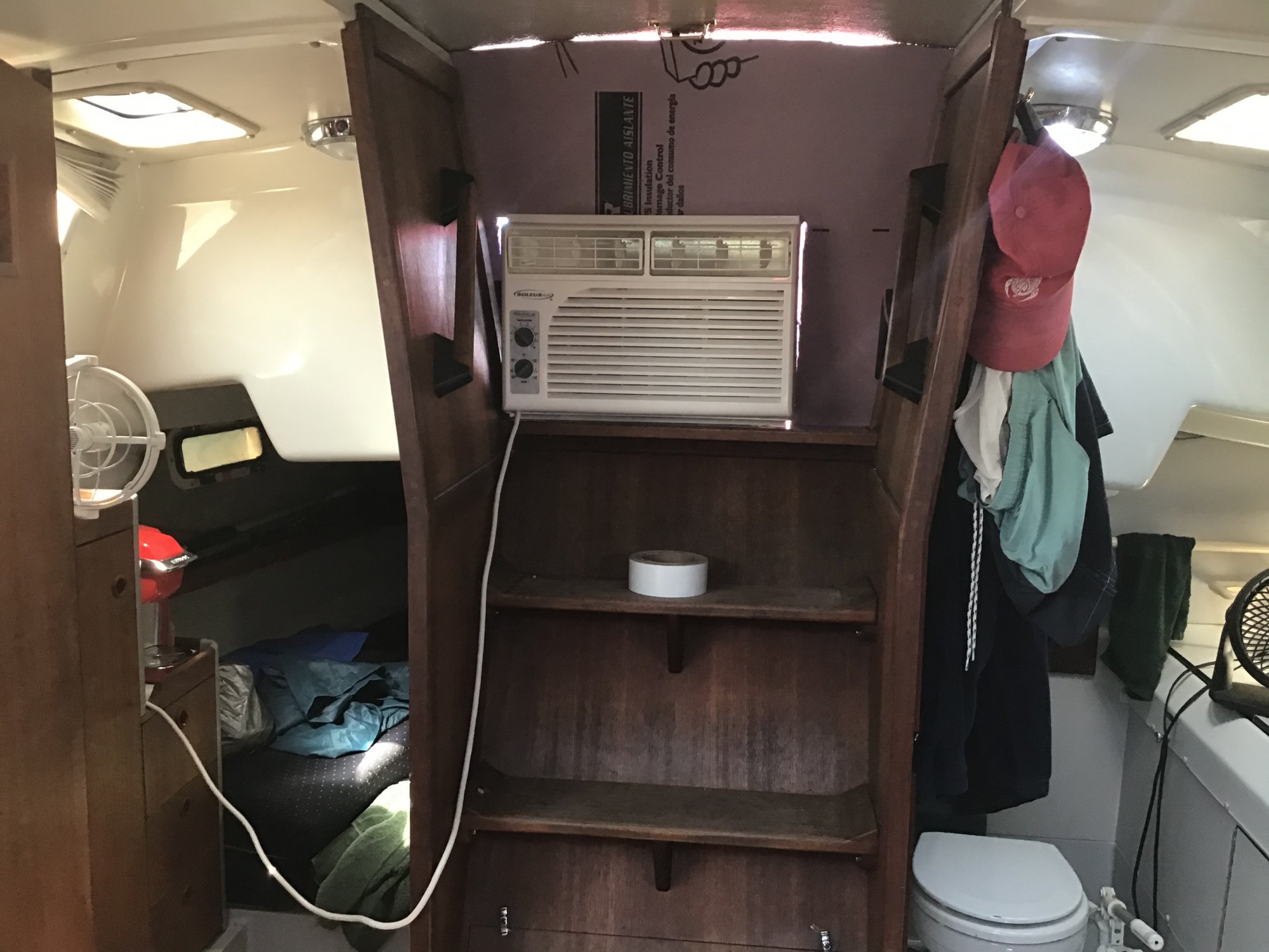

I bought a used 5000 btu window unit and placed in my companionway. I made some foam boards to close off the companionway.
It worked Ok, useless it was REALLY hot. Then it struggled to cool the boat.
I am considering a portable unit (that uses a vent hose to expel the hot air) to see if that works better, and it won’t have to be removed when I want to sail…

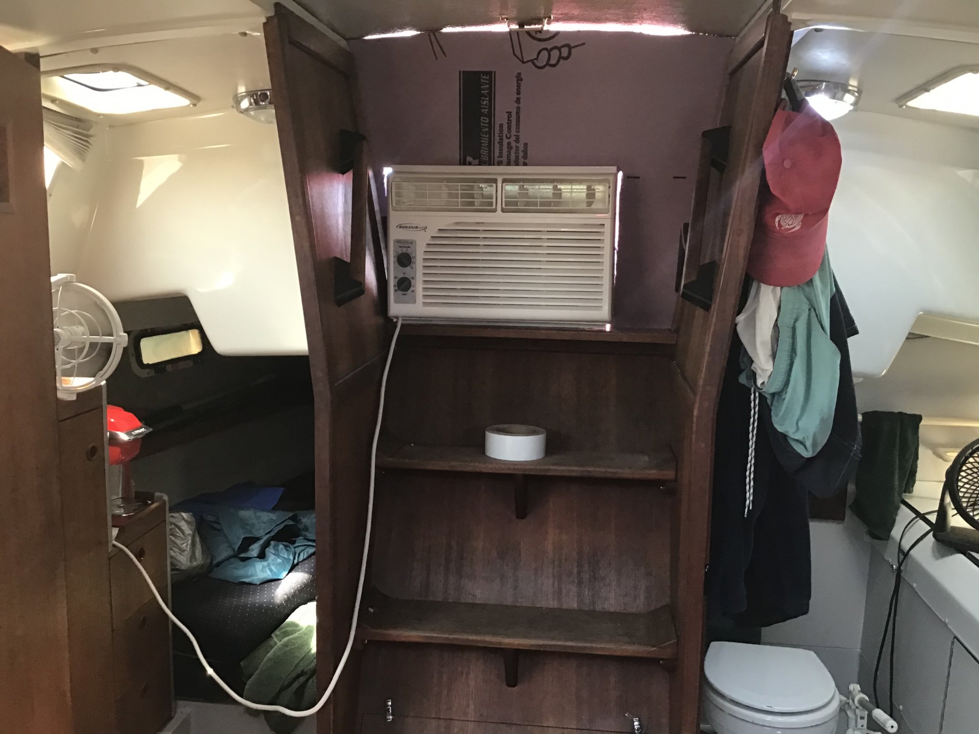

I am considering a portable unit (that uses a vent hose to expel the hot air) to see if that works better, and it won’t have to be removed when I want to sail…View attachment 202632
