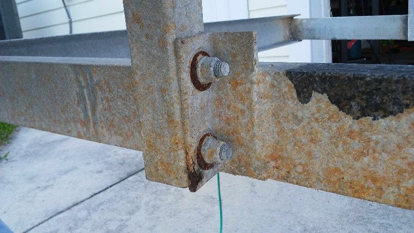

Here's a pic of the current setup:
So this is the existing cross member that I'm cutting away. When I build the new one, I'm thinking skipping the angle bracket you see here and just welding the vertical tube directly to the frame.

I understand that the weld joints will have no corrosion protection but the only alternative is to buy a new trailer. As it is, I'm looking about about $100 worth of steel and a couple of weekends worth of work. If that puts off buying a new trailer for a couple more years than it seems like a good deal to me.

If you are welding it yourself it is easy to fix it again later. If you were paying I'd suggest galvanized u-bolts

You can buy those galvanized square stalks in longer lengths and cut to length as needed. You could also buy the next size square tubing and weld to the trailer with two holes cut with welded nuts attached so that you could screw bolts in to secure stalks inside in place

I wonder if it was built with the angle pieces welded to the frame rather than the square tube because the radius of the tube makes for a more difficult weld than the flatter edges of the angle stock. Or perhaps it was just easier in the manufacturing process to keep the whole frame lower when stacked and sent to be galvanized, then bolt everything on afterwards.

Thanks again for the feedback guys. I decided to just weld the tubes on. I don't think the small radius on the side of the tube is a problem. I was mainly worried there might be some structural advantage to the original approach. I can always cut them off and re-weld if I need to.
