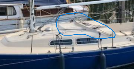

MARIEHOLM IF International Folkboat Smiling Cove Marina Saipan
I have been sailing Marieholm IF Hull # 365 in Saipan, CNMI for 16 years I am not aware of her previous name, however it has been named S/V OFFICIAL BUSINESS here about the year 2000. In 2012, I performed an initial refit repairing years of neglect for hull, rigging and cabin. The Philippine Sea and Western Pacific Ocean is not very forgiving, but the boat performs very well here between Northern Mariana Islands and Guam. I am interested in refitting the companionway hatch cover which has been missing since before I owned the boat. I would like to be as close to the stock design as possible with the foundation for the dodger included. I have heard that Jachtwerf Kuiper in Sneek, Netherlands is performing refits for these boats. I will be reaching out to them too. Any suggestions for doing the rebuild for this, or mold for having that part recast here in Saipan are greatly appreciated.
