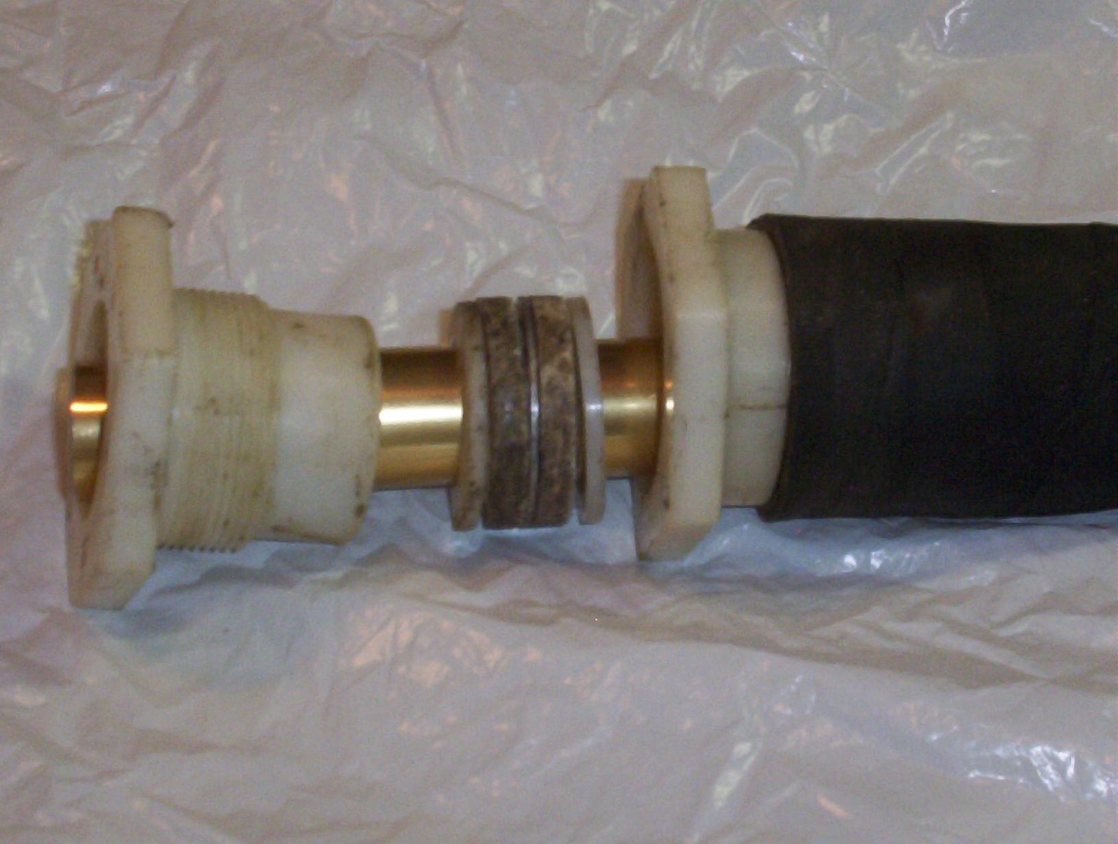

I'm not sure if you have the white nylon OEM stuffing box that some of the older Hunters (like my h28.5) had, but if you do, be aware that you must remove the compression washers separating the packing material in order to properly replace it. I could never do that on my boat without removing the shaft and the entire gland. I eventually replaced the OEM gland with a conventional bronze gland that is very much easier to repacke. See image (I hope it's there...)
