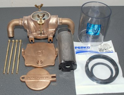

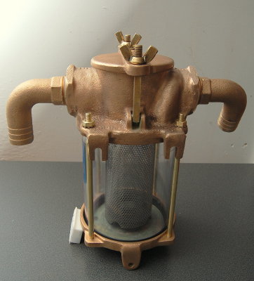

Due to my cracked Westerbeke bell housing I am doing a bunch of other small projects.
I just finished rebuilding my sea strainer and posted it on my site for those interested. I'm sure not many do this but the gaskets do get old and eventually begin to leak. Most strainers are below the waterline so the occasional rebuild is a safe practice.
Clean & ready for re-assembly:
All done:
Rebuilding a Sea Strainer (LINK)
