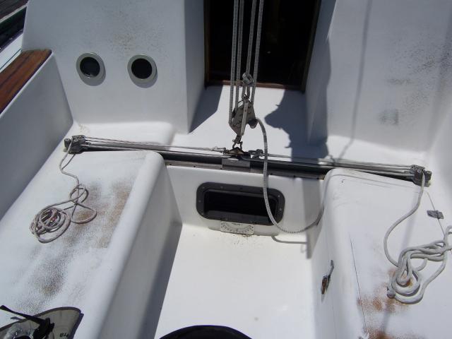

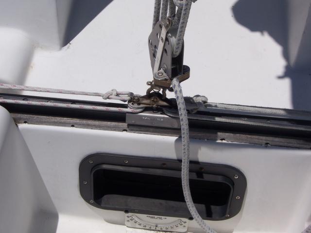

I had been noticing a problem with water collecting below the engine. Could not figure out where it was coming from but by luck was there at the right time to see the leak in progress. water is coming in at the place the traveler is mounted.
Given the load the treveler's rail must take under sail is there anything special I should be doing during disassembly and remounting. I am also thinking of replacing the teak with trex but was not smart enough to figure that out till after I came home and the boat is half an hour away so if anyone has the measurements that would be very helpful and save me running around.

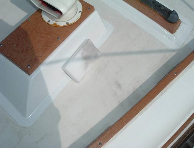

Sorry, can't help with the measurements. But the cost difference isn't enough to really need it. Just order a five foot piece of 1 x 3. It is really easy to cut and shape. I did this years ago on my front traveler. I use PlasTeak because they are ten miles from my house( http://www.plasteak.com/osc/ ). In the picture the dorade covers, rails, and traveler base are all PlasTeak.

I don't have your model, but reading your initial question, maybe some things to investigate/consider:
- Underneath, are the bolts just secured up against the underside of the fiberglass with washers and nuts? If so, making backing plates out of teak or other rot resistant hard wood such as IPE (common decking material) would add rigidity and distribute the strain more evenly.
- Give thought if Trex is rigid enough. I would think that since its made with a lot of recycled plastic of all sorts, it might compress over time with the tightness of the bolts. Then eventually cause the installation to loosen and leak again. Again, IPE should be readily available and is not terribly expensive. Your call on this.
- This might be a good project for butyl tape. You might want to search for articles on this topic on the Ask All Sailors by Maine Sail.

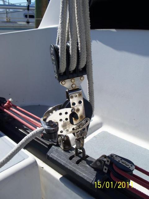

Thanks again everyone, tomorrow sounds like a good sailing day so procrastination will win out I suspect. Did some research (translation asked our staff carpenter) into if a synthetic like Trex or Plasteak would work. Based on the limited research the answer seems to be yes, while it doesn't do well with torque, compression is not usually and issue, it apparently will twist but not compress. Since it will be bolted flat with the traveler bolted above I don't think twisting will be an issue.
As to going to a better traveler, Ed yours is already a generation newer, I have the one with the drop pins, which means it if loads up badly enough it can't be shifted. Should change it out but have used this year's allowance up. I would lover to consider going to a cabin top rig, but more money than I have left for this season.

No, we have the same traveler. The picture is of Blaise' traveler, the one that just won the "Regata del Sol al Sol". I agree re. compression and twist. My front traveler base out of PlasTeak is not going to compress.
