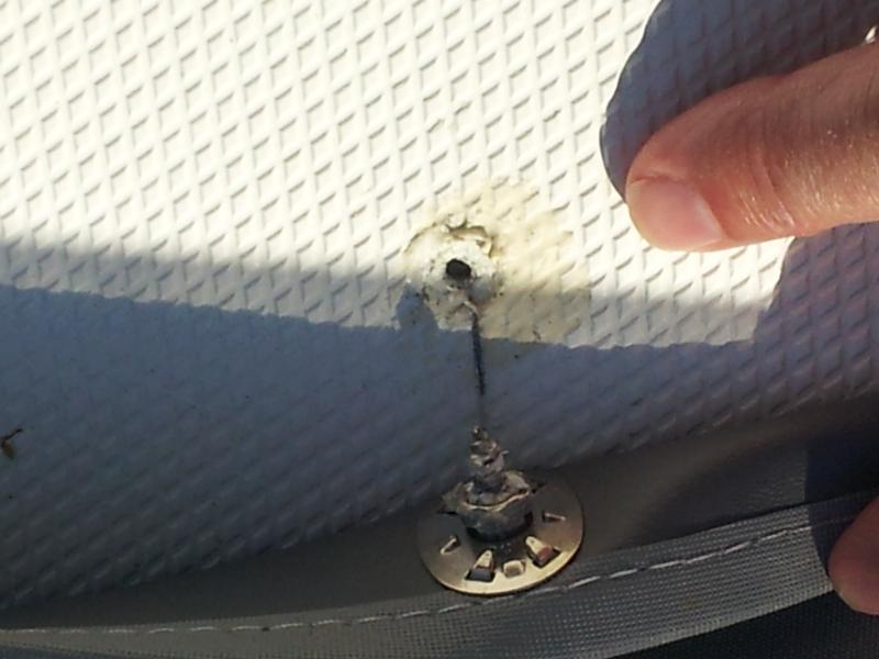

Anyone have ideas how to rebed the fitting shown in the attached? I want to make sur it seals and stays. Really appreciate it!

Fill the hole with epoxy or even polyester. If you use poly it will probably settle in and you will have to do a second fill. The hole seems sort of small so you may need to enlarge the hole. After it is set drill a small pilot hole and screw it in. The thread on the snap fitting looks a little bad so a new fitting would be in order.
